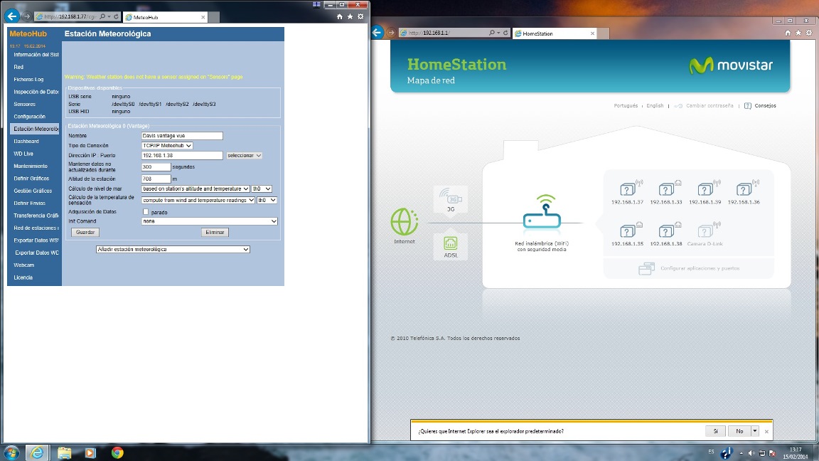

This is the screenshot of the settings to meteohub davis vue:
The ipa 192.168.1.35 is the IP that my router gives the weather station davis vue. What is wrong?

Re: davis vue help connect with WeatherLink IP meteohub
wrong setting "TCP/IP Meteohub", correct for WLIP is "TCP/IP".

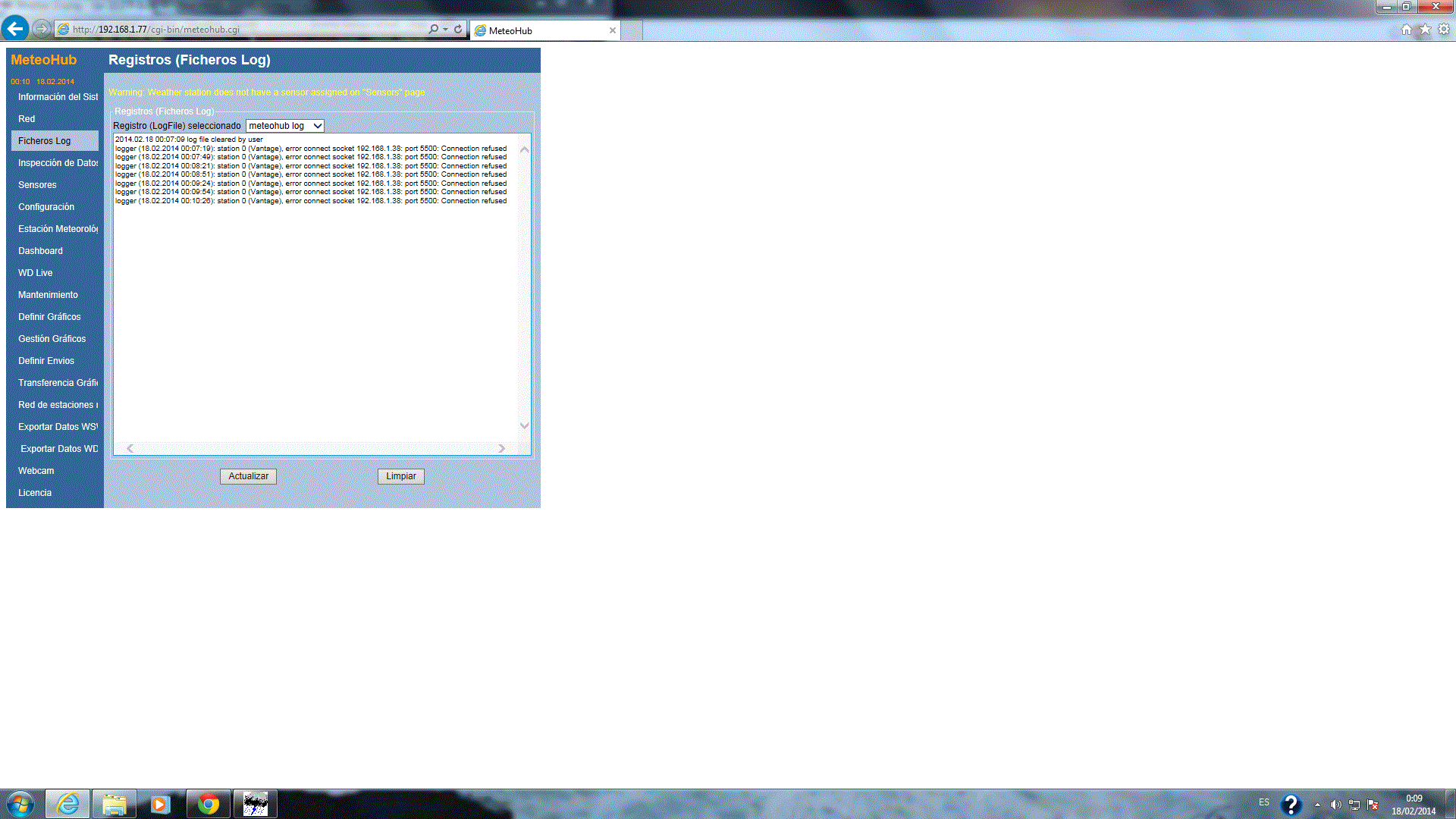

Meteohub log indicates that you still have "TCP/IP Meteohub" selected.
As said, that won't work. Please change that.
What is the port your WLIP is listening to? 22222?

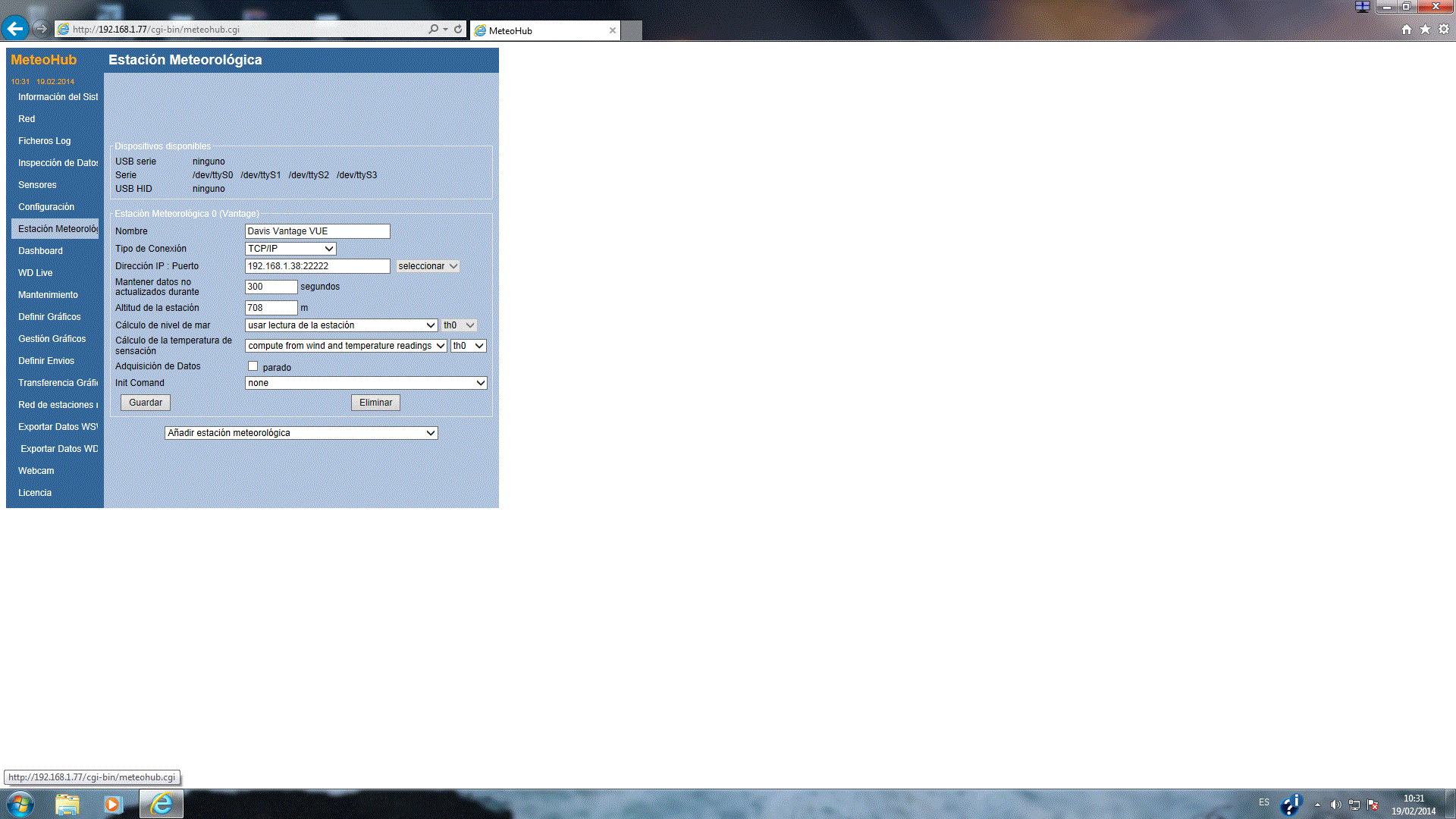

Post by somiedo »
Hello, good morning administrator. Knocked the weatherstation and I went back to add, this time with the setup tcp / Ip, I added the ip manually with the same access port that weather link (22222) 192.168.1.38:22222. And it all works perfectly!!! Administrator thank you very much for your help and your time spent on this problem. I am very grateful.
