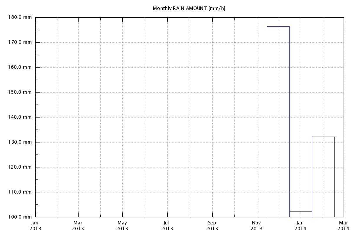

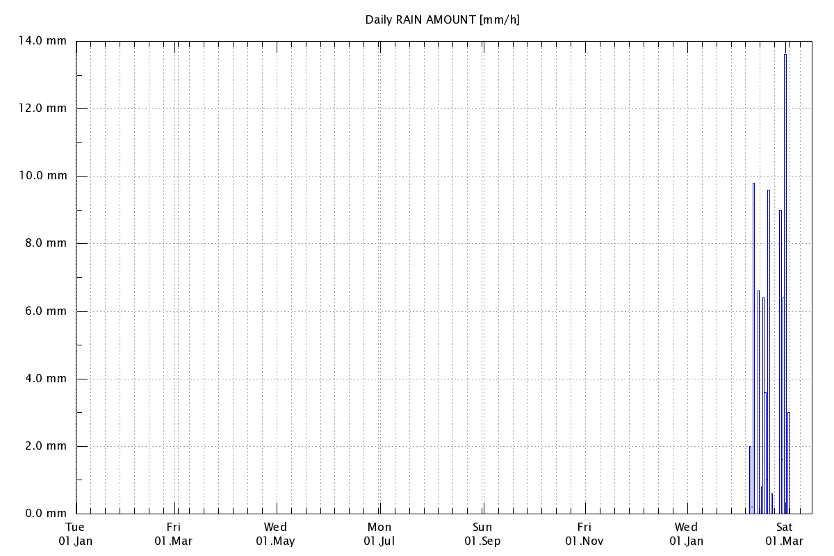

Short history: I installed my Davis VP last year (1 Feb 2013) and Meteohub run correctly during the whole 2013 and till january 2014. Last month, I noted that the software was no more able to plot the data of last year (see attacched images). Firstly I though that the data has been deleted from the archive, but when I export them, I can retrieve the data since 1. feb. 2013.
Someone could provide some inputs, please?
Thank you very much,
Luca

Since the graphs are using aggregated data, the 1st thing I would try is to run a "recompute" (on the maintenance tab). Once that process is finished try it again.
If not, please list the settings that you are using to generate the graph (aka the definition).

actually after the recomputation the plots are visualized correctly. I suspect, that the problem was an interrupted recalculation that did last month.
Thank you very much for the suggestion,
Luca

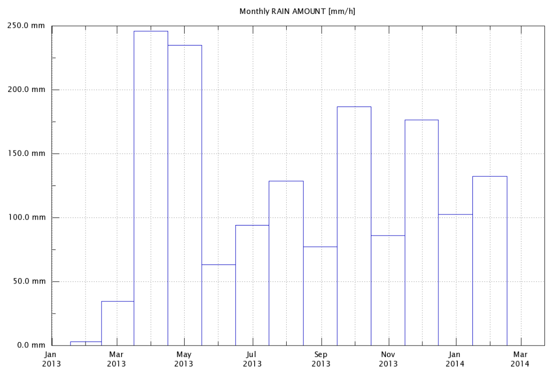

Example monthly rain since feb. 2013:
