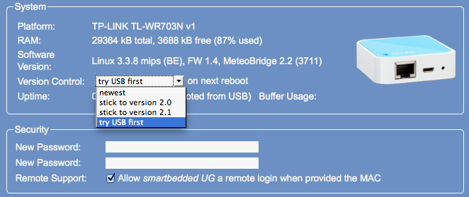

Re: How much data is recieved at startup by meteobridge?
I checked the code and implemented a drop-down menu that allows to select "USB first" as boot option. Doing some tests with my WR703N it seems to work. Anybody interested in testing that? Please send MAC to "info(at)meteobridge.com" to get access to the new beta code to help me testing this feature before making it available to the broader public.
Screen Shot 2014-04-18 at 11.24.44.png (64.94 KiB) Viewed 5444 times
