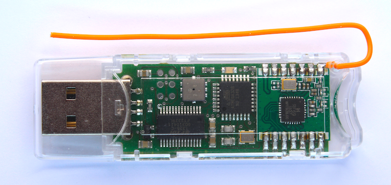

  • adds Meteostick as a new weather station. Meteostick comes in the shape of a USB stick and can read RF signals from up to eight Davis weather stations. By that it is not blocking the Davis datalogger in the console and you can run Meteohub without interfering with your traditional Davis PC connectivity. More details about this new Davis connectivity option can be found at http://www.smartbedded.com/meteostick
