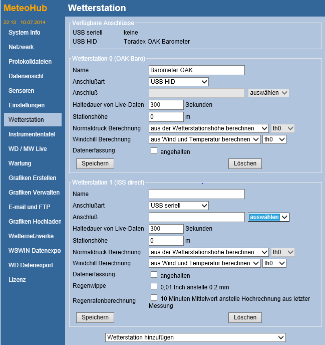

Re: AKITIO USB Problems
Looking in more detail onto your first mail, it looks like you failed to configure "ISS direct" as "USB serial" and giving it a proper device name like "/dev/ttyUSB0" or so. Please send screen dump of "weather station" page.
Manisflight
- Junior Boarder
- Posts: 36
- Joined: Sun Jan 29, 2012 12:36 pm
i cant choice device name like "/dev/ttyUSB0" or so
- meteohub.PNG (44.71 KiB) Viewed 15395 times
Then ISS direct adapter is not recongized by your Meteohub system. Can be a defective adapter, or a defective DC01, or a missing driver.
