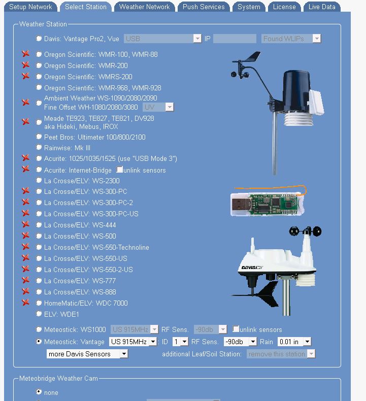

Is it possible to get the Meteobridge with a Meteostick to see an add on Leaf /Soil station? It sees the ISS just fine, but I cannot get it to see the Leaf Soil station. On the Select Station page I have Meteostick: Vantage chosen. I see the drop down for "more Davis Sensors". I choose "Leaf / Soil Station" and press the Save button, but it does not stay.
Any idea how to get it to work?

You also have to select the correct transmitter ID for the Leaf/Soil Station. It does work fine with mine.
Can you please share a screen dump of this with us?

Here is a screenshot. The ISS is transmitter 1, and the Meteobridge sees it. There is no way that I can see to set the Leaf / Soil to transmitter 2. The drop down box is greyed out. When I click save, the Leaf / Soil just disappears. If I set the Vantage option to transmitter 2 nothing is found.
I am think of switching from my Meteohub to a Meteobridge and the Meteostick works fine with the Meteohub. There it can see both the ISS and Leaf / Soil without issue.

Re: Meteostick with Davis Leaf Soil station
It has to look like this:
Screen Shot 2014-11-07 at 22.20.04.png (15.72 KiB) Viewed 3712 times
But the latest Meteobridge version had a bug that dimmed the selection of transmitter ID for additional sensors.
I just fixed that, so please reboot your Meteobridge and make appropriate transmitter ID settings.
Thanks for spotting this bug.

Excellent! Works great now. Thanks a lot!
