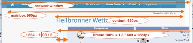

And in that 680px wide content you are putting an iframe with settings:
<iframe src="http://heilbronner-wetter.de/weather2/index.php?p=10&lang=de&ipad" height="1000" width="180%" frameborder="0" scrolling="no" align="left">. .. . </iframe>
So the wide of the iframe is set to 180% = 1,8 * 680 = 1224 pixels and will extend to the right outside your main page.
The real contents of the iframe is 1100px so the remainning 114 px is to the left / right of the index.php you are displaying inside the iframe.
I made a screenshot to explain a bit as it is difficult to explain in "my" English.
