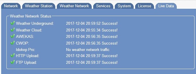

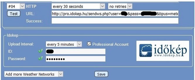

Re: MeteoBridge to idokep.hu
I set up username and password on weather networks tab. Unfortunately the upload does not work without the HTTP request command.
It works perfect with http request.
SW Version: Meteobridge 3.4 (Dec 3 2017, build 11655), FW 1.5

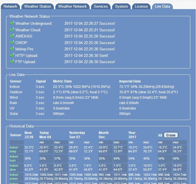

I found out that sending was never triggered by Meteobridge. I just fixed that bug and released a new version. Can you please reboot and try again?
I would love to have this issue fixed.
Kiskrampusz
- Fresh Boarder
- Posts: 13
- Joined: Wed Nov 15, 2017 8:51 pm
OK. Thank You! Everything is perfect. Updated every 5 minutes.
