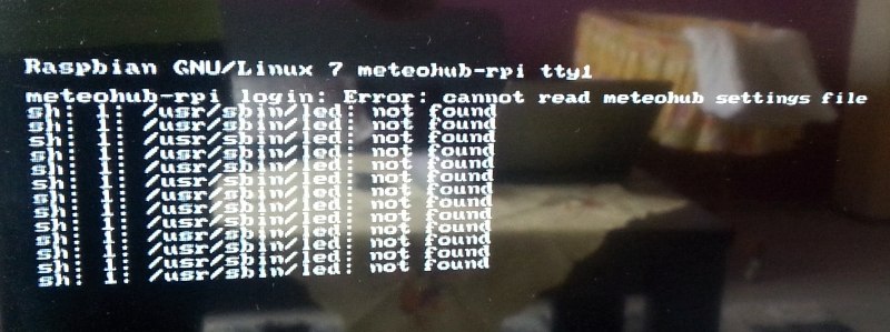

I bought a new RPI-2 and I have now problem. The installation went well, RPI-2 is rebooted, and then ran again - probably some additional installation and setup Meteohub.
At the end when the login occurs after 5-10 seconds the error: Error: Can not read metehub settings file. :twisted:
For sure I RPI-2 installed another OS: RASPBIAN or RISC OS and everything was installed well.
Unfortunately I do not know anymore advice. Advise anyone?

Today I bought in a store rather new Kingston 8GB - 10 class, installed meteohub and again the same error. Have you really do not know advice :(

Are you on current version 5.0i?
What is not working with the system, apart from these console messages, that don't disturb operation?

I use version 5.0f from this site: http://wiki.meteohub.de/Images

admin wrote:What is not working with the system, apart from these console messages, that don't disturb operation?
Is there a malfunction or just cosmetics?

At RPI-2 can not connect via putty or via the web (port 80). But responds to pings. I bought RPI + B, where 5.0f version also does not work and lists the same mistake. Therefore, I downloaded version 5.0 and older to RPI B + everything works.
I think that version 5.0f contains an error.
