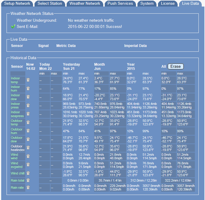

I have attached a screen shot of the Live Data tab. It shows a push email sent, but it contained no data when received.

But there is no data coming into the meteobridge.
So there is no data to sent to WU.
The live data tab shows no data for today, only data for yesterday and older.
Also there is nothing below live data.
Check the cables between station and meteobridge
I do not see this in your screen shot. No data, no communicating, logger lines tell the same.The weather station is communicating with the Meteobridge computer OK and the Live data tab shows the same data as the display with the correct time.

I had several Live Data screenshots and attached one that showed no current data. Another one did.
However that fact that one screenshot was missing data plus the line in the log about "logger (22.06.2015 13:53:08): usb port reset." made me think that the issue was with the weather station console USB connection to the Meteobridge computer.
We restarted the weather station console, reconnected the USB connection and then also reset the Weather Underground credentials and immediately Weather Underground started to receive data.
