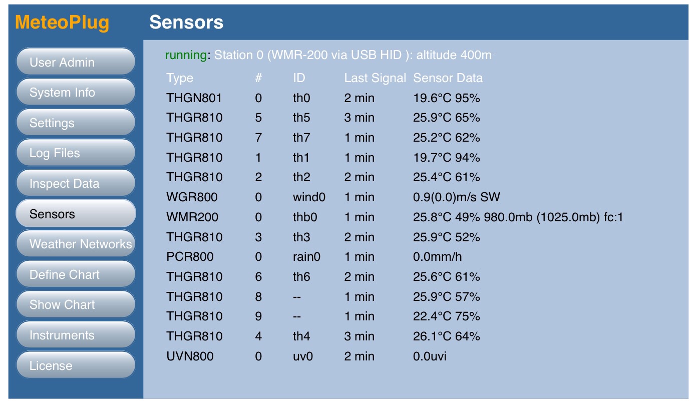

does it allow you to set a calibration factor at the Meteoplug cloud service?
I would expect this being part of "sensors" page.

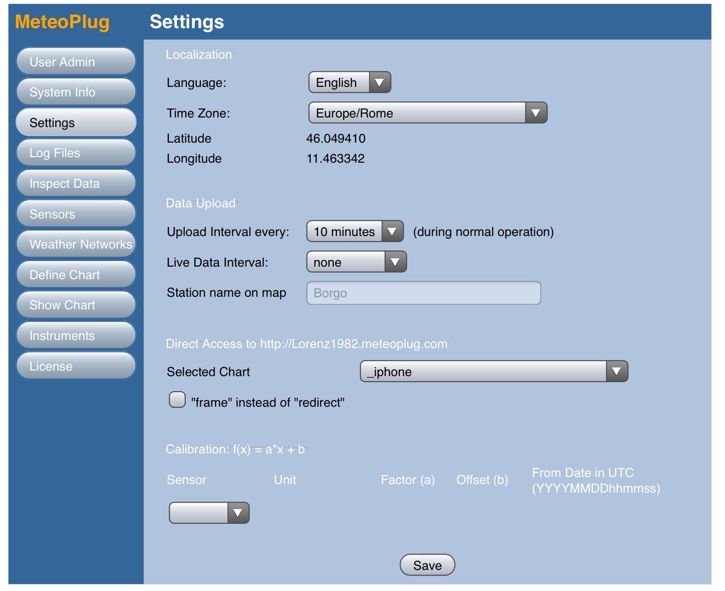

In Meteoplug isn't possible to do it. The calibration function is disabled. See the imagines.

Re: Rain Multiplier
Are you sure that it is disabled? From the screen dump it looks like being selectable.

admin wrote:Are you sure that it is disabled? From the screen dump it looks like being selectable.
No, when Meteoplug is connected with Meteobridge the calibration function is disabled. You can see this because in the imagine the words are white.
Do you want we write us in private mode so I give you my password so you can do a prove?
