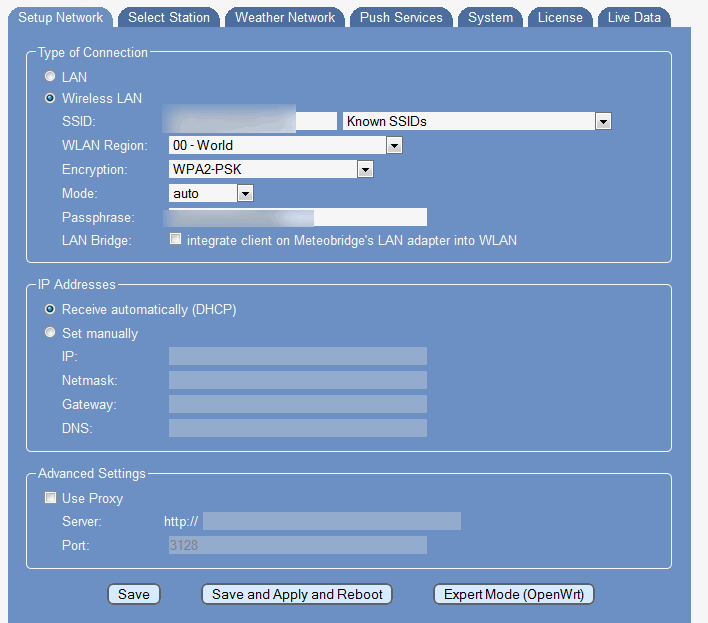

My Meteobridge TL-MR3020 worked perfectly with my Davis Vantage Pro2 via USB (with a USB hub) via my wireless LAN for over a year. However, I recently changed wireless routers and since that time I have been unable to upload live data via Meteobridge. Meteobridge software version is Meteobridge 2.5 (Jul 3 2015, build 6646), FW 1.1. The problem began when I reconnected the MR3020 to my new wireless LAN.

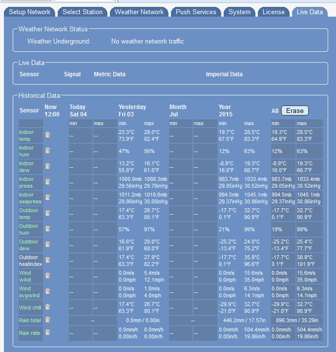

The Vantage Pro2 is on AC power and the batteries are fresh. I have reset the Vp2 and rebooted the MR-3020 many times. Other than replacing my wireless router there have been no hardware changes - same VP2, same MR-3020. Historical data uploads daily without any problem. There is no live data.

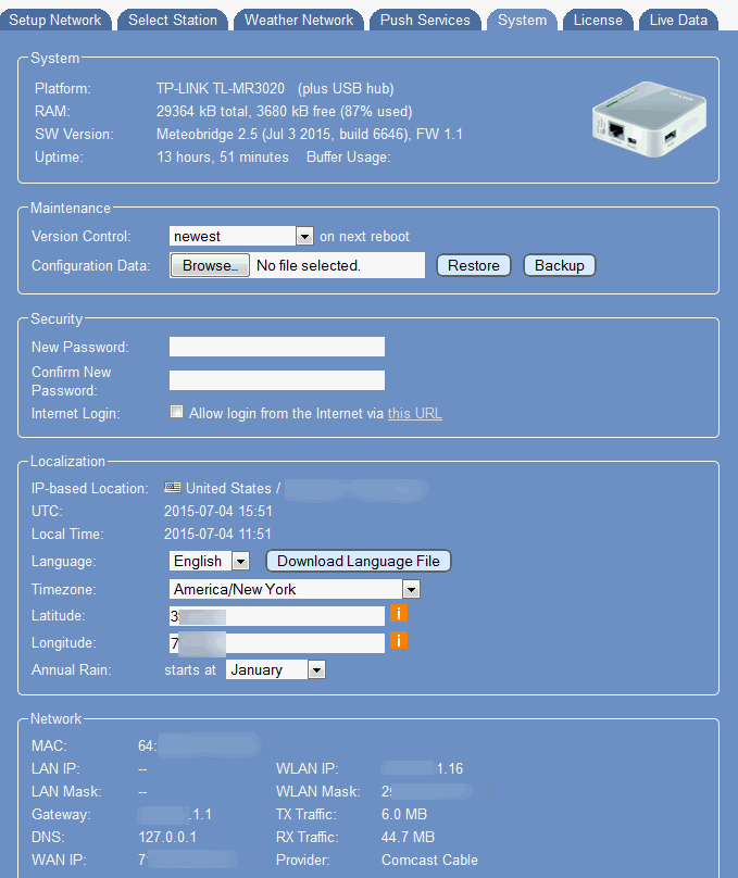

Screenshots of set up network tab, system tab data and live tab:
