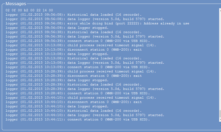

As promised a screenshot of the message box, i must do a reboot in order to solve the problem.
last hours nothing but trouble......
Well hope with next update i will be able to go back to 2.2
Ram usage is 87%
Thnx. Tjeerd
Ram usage is 87%
Thnx. Tjeerd
- Naamloos.png (41.49 KiB) Viewed 5370 times
Re: Still having issues with latest version 2.5
I doubt going back to 2.2 will solve your issue which looks to me as being related
somehow to your specific weather station. However, when you reboot you will
have the latest version installed, that allows to select older versions to boot with
on next reboot.

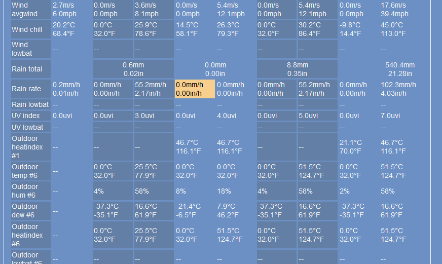

Hello.
Now things get really strange.
Two days ago I gave the latest version a try.
Works fine for a day, then the trouble starts.
Somehow my data on the live data tab is not updated, all the sensors except indoor temp are shown in red as they are old data.
Rebooting meteobridge solves the problem for a while.
Now I'm back to version 2.2 which is still the most stable version for me.
But now the live data tab shows sensorvalues which I don't use and I can't get rid of them.
Gr. Tjeerd
