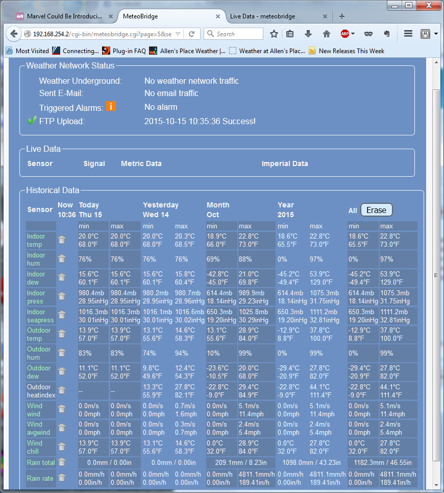

Yesterday at about 1:30 AM EDT it quit uploading to Weather Underground, The Weather Network page still shows checks by Station ID and Password. I get emails from Weather Underground saying the PWS is down. Live data shows "Weather Underground: No weather network traffic" But if I click "Save" on the Weather Network pages, the clicks stay and I get an email from Weather Underground saying the PWS is up. But no weather shows on the the Weather Underground page http://www.wunderground.com/personal-we ... =KGATOCCO3 and later I get another email saying it is down. I have it send me an email every midnight with some stats and that works, it also FTPs data to my personal website and that works

Note my live data screen doesn't look like http://meteobridge.com/wiki/index.php/Live_Data
I am attaching a copy of what it looks like.

Re: Strange Problem
As you can see in the empty live data section there is no data coming in from the weather station.
Therefore, the weather networks are not fed anymore.
Please have a look at the messages section on "system" tab to find out why.
