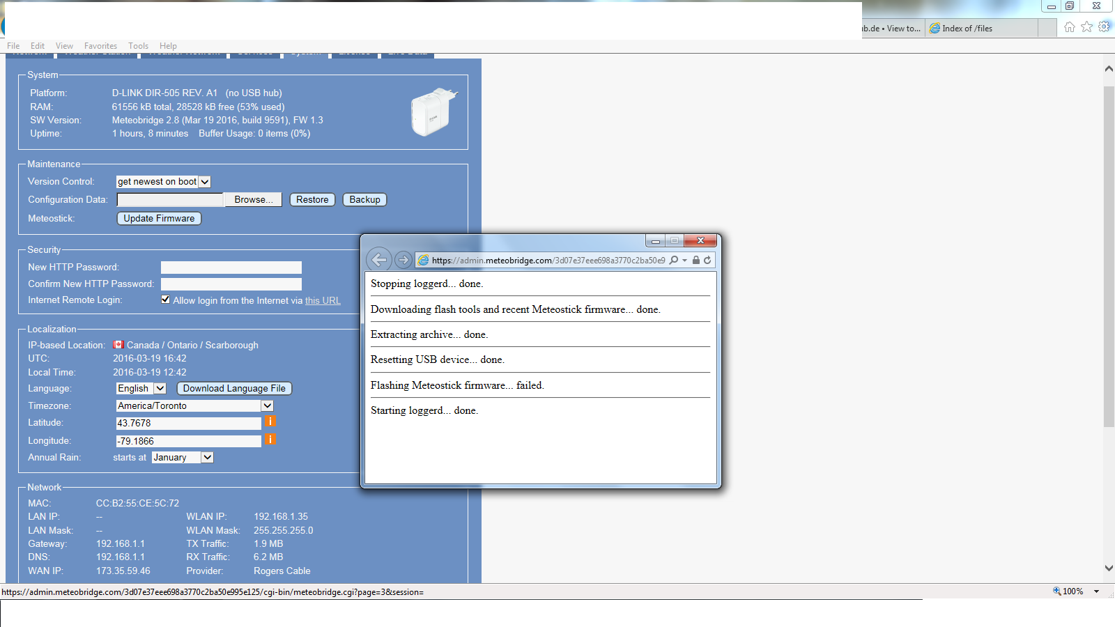

Running Meteobridge with the newest firmware. When I try to upgrade the firmware on the MeteoStick, it fails.
System
Platform: D-LINK DIR-505 REV. A1 (no USB hub)
RAM: 61556 kB total, 28676 kB free (53% used)
SW Version: Meteobridge 2.8 (Mar 19 2016, build 9591), FW 1.3
Uptime: 1 hours, 25 minutes Buffer Usage: 0 items (0%)

I tried 6 times. Each time it failed.

I guess I could take the MeteoStick and upgrade the firmware on a computer. I just don't get why it fails in the D-LINK DIR-505 REV. A1 Device.
I tried multiple times at once and it never update the firmware.

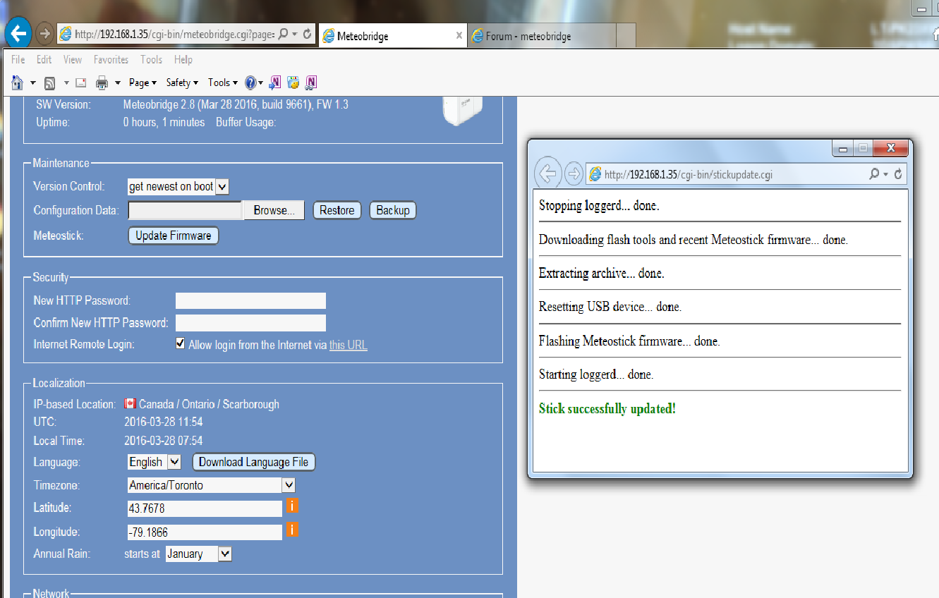

Was a DIR-505 specific problem. Is solved by latest update.

I rebooted my DIR-505 and the newer version worked for upgrading the MeteoStick. Thanks for fixing it.
