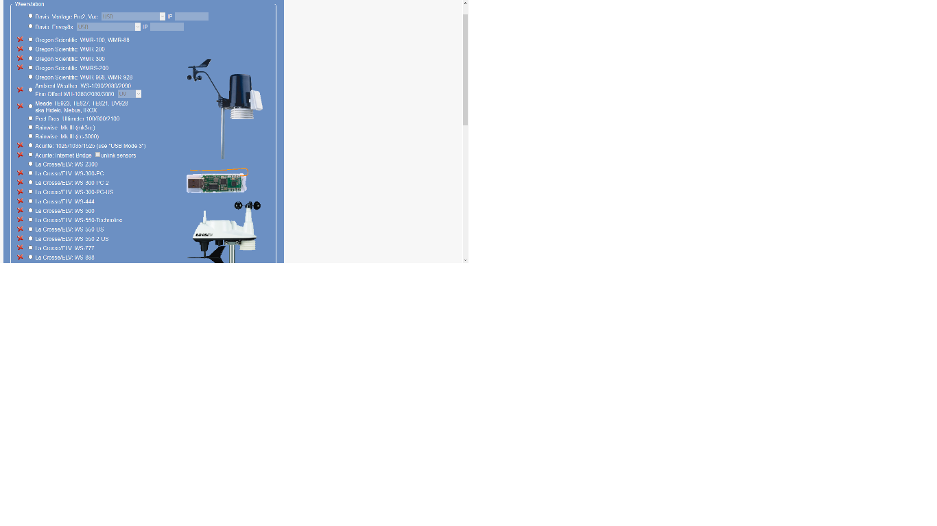

I'm behind last night (before there was nothing to advance) that the images in the MeteoBridge webintervice are no longer visible where under the ticks and crosses on the tab Live Data and Weather Station is not the text no show there is now
The image of the MeteoBridge itself used is no longer visible on the System tab.
Featherweight he just works and submit all data again.
Forgot to mention when I have a MeteoBridge TP-LINK TL-MR3020 (plus USB hub)
SW Version: Weather Bridge 2.8 (18 Apr 2016, build 9778), FW 1.4

I can confirm that images are missing from the web interface on Meteobridge Pro as well. Brand new system started today running software v2.8, firmware v1.4.
Re: Meteobridge image disturbance
No such issues here with MB or MB Pro for FW versions 2.5 and the latest 2.8
No problems in 2.7 on a TP link running FW 1.2 or 1.4
Is the problem still there with the latest build from April 23?

I'm having the same issue with missing images the crosses and checks are missing but not all of them.
Also with the release of 23 April a big difference on raintotal/day with console and the amount gathered by meteobridge.
Now 4.8 mm on console and meteobridge is showing just 1 mm.
Rain rate is ok.
I'm using meteostick version 2.5 with Davis vantage pro2.
All the other data is ok.
Seems like the latest version does not fix this problem.
At first everything was working fine since a test of mine it is gone bad.
Also when booting I get a message no such file or directory for a few times before it is able to recognize the meteostick.
Gr. Tjeerd

Unfortunately, updated April 23, 2015 the same problemadmin wrote:Is the problem still there with the latest build from April 23?

Still missing the cross images on the weatherstation tab, strange as they are not all missing
See attached file.
Gr. Tjeerd.
This looks fine to me. Only the ones that are not connected for sure are marked red X. The ones connected for sure are marked green V. The ones Meteobridge does not know by looking at the interfaces are left blank.

Re: Meteobridge image disturbance **solved**
I can tell you that the pictures do it again in the meteobridge.
