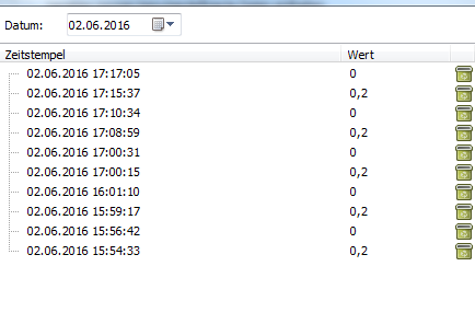

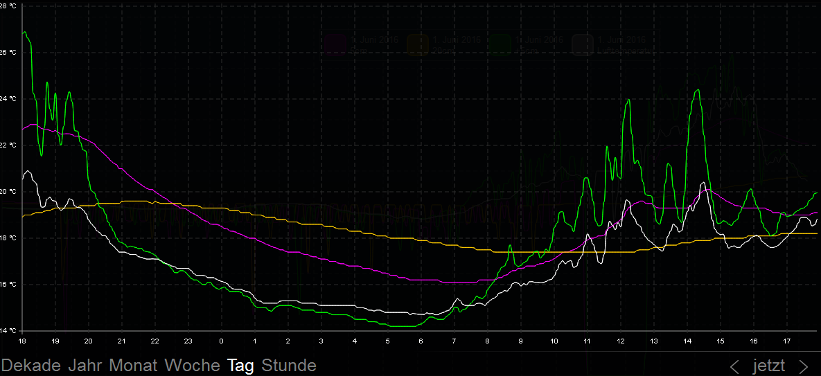

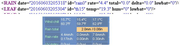

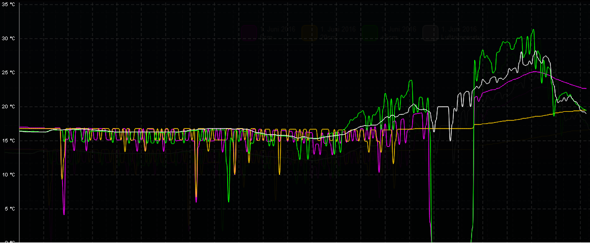

Hello there,
i have a Davis VP2 and a Davis SoilStation. Booth send Data to the red MBPro.
Via the LiveXML Datasheet my HomeAutomation System gets the Weather data.
Since Update yesterday, i get often Zero or wrong Values from the MB Pro.
And the History Data are gone - i only have my Today VAlues in the History and MIN/MAX? Thats not the Problem, because i log it anotherway, but strange?
And the Rain Value only goes one Step to 0.2mm and the Back to 0.
@Admin - ive sent you my access data via PM

One Problem may be, that the Datalogger restarts suddenly and the XML shows an error instead of datas. Then every second the logger comes back with more data until it is normal.
So the result is that the rain gehts never over 0.2mm before there is an restart.
ive testet FW 2.8 and 2.9 and get same problems. Before Update, it works fine

now its raining again...
The XML livedata goes maximal up to 0,2mm. The liveData Tab in the WebGui shows the sum since restart

Whats going up with the MbPRo?
After a few hous working, wih the problems above, there a no XML Data.
logger (04.06.2016 20:26:28): station 0 (Meteostick Vantage), can't open device /dev/ttyMH: No such file or directory
logger (04.06.2016 20:26:58): station 0 (Meteostick Vantage), can't open device /dev/ttyMH: No such file or directory
logger (04.06.2016 20:27:28): station 0 (Meteostick Vantage), can't open device /dev/ttyMH: No such file or directory
logger (04.06.2016 20:27:58): station 0 (Meteostick Vantage), can't open device /dev/ttyMH: No such file or directory
logger (04.06.2016 20:28:28): station 0 (Meteostick Vantage), can't open device /dev/ttyMH: No such file or directory
logger (04.06.2016 20:28:58): station 0 (Meteostick Vantage), can't open device /dev/ttyMH: No such file or directory
logger (04.06.2016 20:29:28): station 0 (Meteostick Vantage), can't open device /dev/ttyMH: No such file or directory
