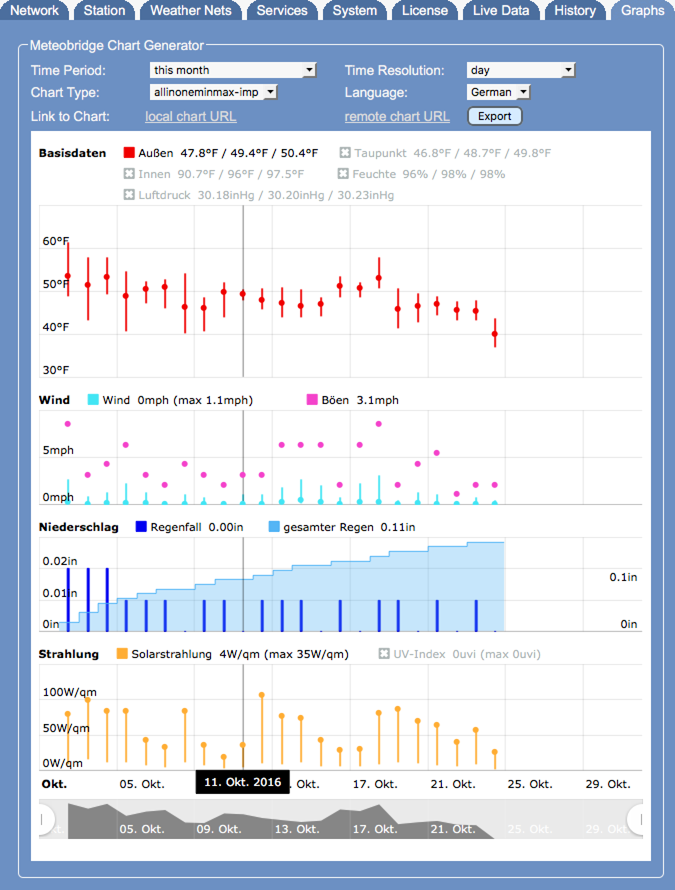

My Station is a Davis Vantage VUE, so I have no Solar or UV sensor.
Therefore the Solar/UV graph is empty.
Is it possible to ‘disable’ the Radiation chart?
/Michael
Re: Meteobridge PRO can now generate interactive graphs
it should suppress radiation data when no sensors there. I will check this.

Unfortunately, It doesn't suppress radiation data.
You are welcome to take a look here:
http://frederiksberg-vejret.dk/ChartTodayMin.php
I rebooted the Meteobridge to upgrade to "released October 23, 2016" but it's still says "Meteobridge 3.1 (Oct 20 2016, build 10630), FW 1.4"
/Michael
Just release update should handle non-existence of solar/uv sensors correctly and we have new chart types showing min/max values, which might be particular helpful for daily/monthly views.

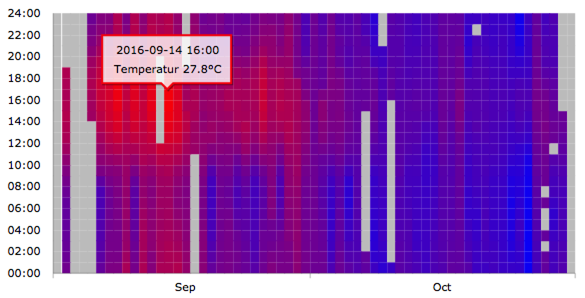

Todays release fixes a bug related to daylight saving time switches and adds a new graph type, called heatmap.
Heatmaps show each day in a column, with the hours stacked in the vertical and showing temperatures by colors.

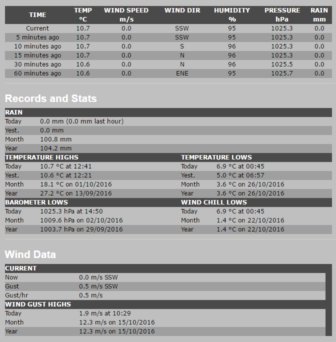

Could you be interested in making an Interactive Graph that show “Weather Trends” like the one that the Saratoga scripts does – but made with JavaScript in the same nice way as your ‘allinone’ do?
:D Michael
wxtrends.php
wxtrends.php
