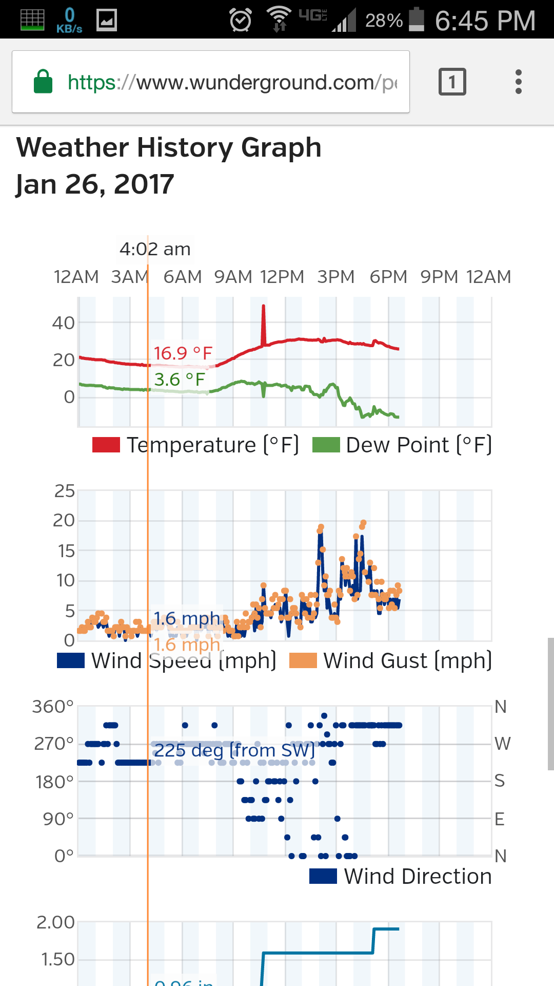

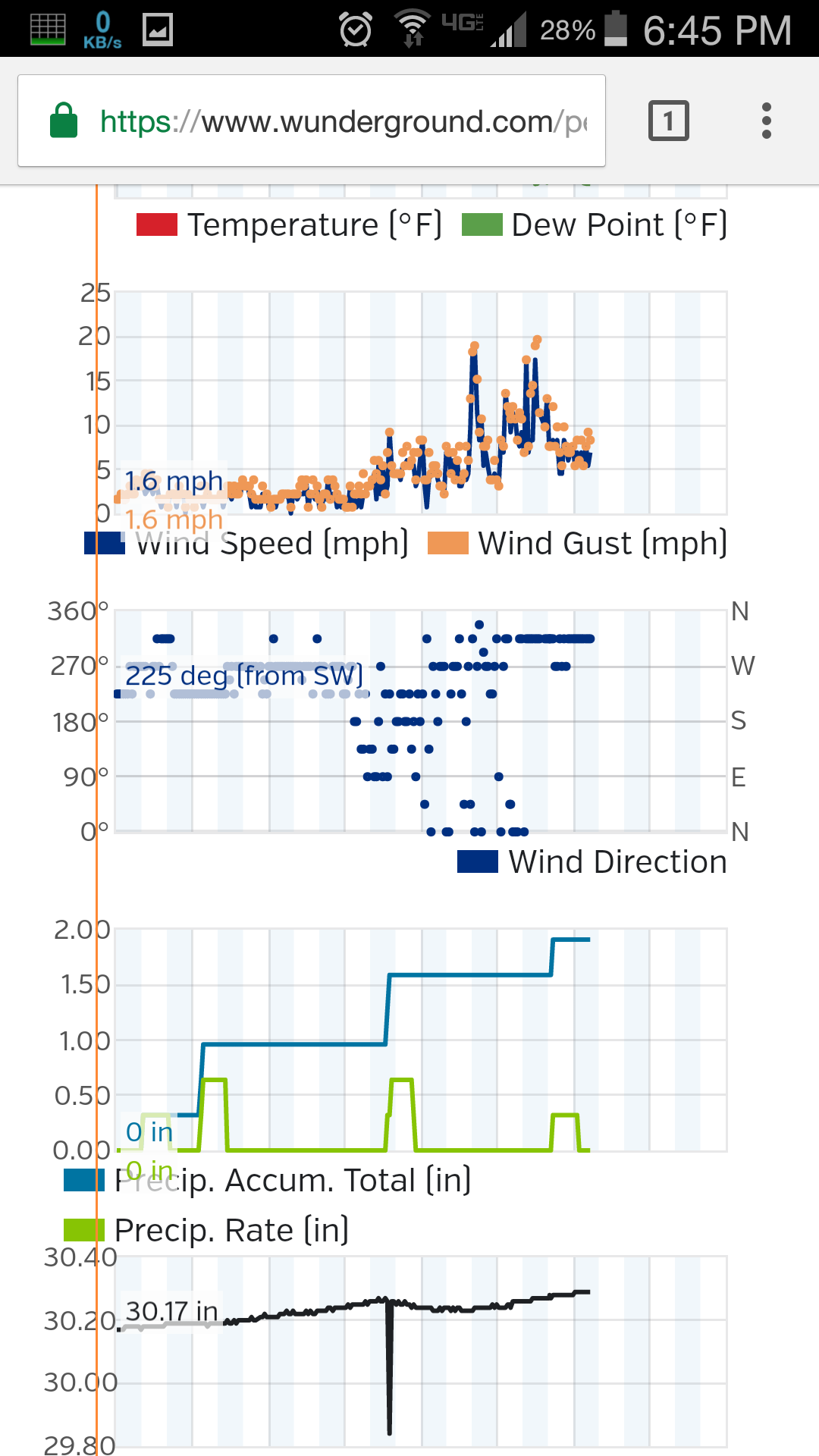

My equipment is a Ambient WS-1090 conected to a DIR-505 via a an unpowered USB 2 hub into the DIR-505 loaded with Meteobridge 3.2 build 10821. Screen shot below of the system page showing no errors. (screenshots of system page and live data too big for here, can emsil if it'll help}.
The WS-1090 shows zero precipitation and the temp here has been below 32F all day, but WU shows blips all at about the same time in temp, dew point, pressure and one of the precipitation jumps.
I have attached screen shots of the blips in WU's station data and looking at live data show Meteobridge 'read' those values.
What could be causing this?
