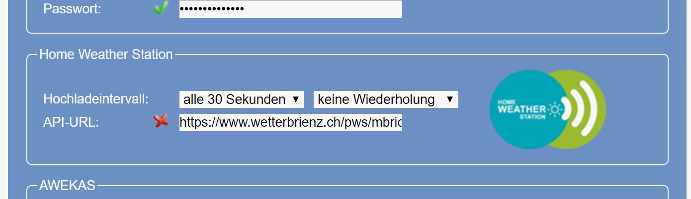

Hello everybody,
with me the red cross still remains.
Have the system also restarted again.

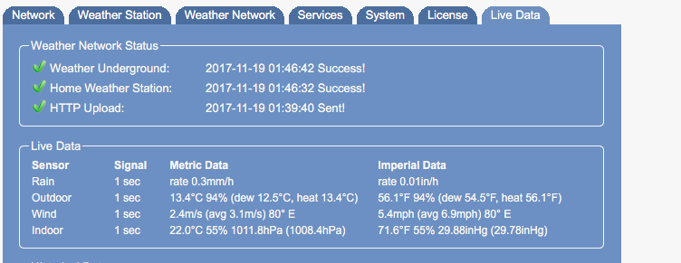

webcam wrote: Fri Nov 17, 2017 8:54 am Hello everybody,
hello just ignore it check the livedata should be returning success see attached . its a known minor bug in meteobridge , boris this is what i was trying to explain the other day. it doesnt actually stop the data being sent.
brian

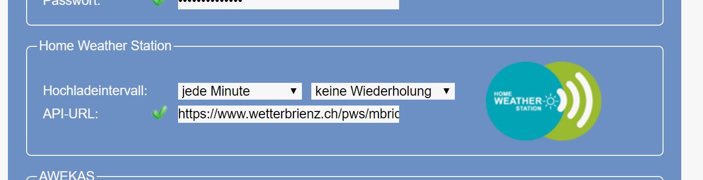

The template works fine. But Boris has indeed made an update at MB, which should solve this problem. Only with me it did not work.
With this fix it works Meteobridge 3.4 (Nov 19 2017, build 11627), FW 1.4
Thanks Boris
