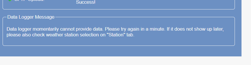

I have a total of 7 stations I am using for different things - 1 wind, 1 ISS, 1 Solar/UV, 3 Soil. I've noticed that after I added about the 4th or 5th station to Meteobridge Pro, that the Datalogger is saying 8/10 times "Data logger momentarily cannot provide data. Please try again in a minute. If it does not show up later, please also check weather station selection on "Station" tab."
Also, some sensors will appear, then aren't getting picked up for long periods even though they are transmitting, and at a fair signal strength (-60 to -65 db) randomly (but rarely), then start working again - Meteobridge will say last transmit 10 minutes, 20 minutes, etc. then randomly like I said they start working again.
Any reason for this?
