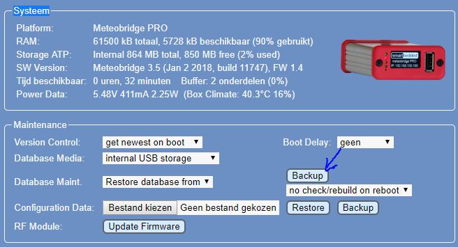

How do i start a data backup by hand?

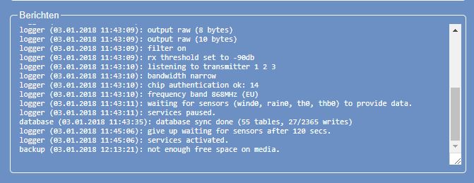

I insert a usb-stick 16gb (fat32) in the front connector and press backup. Then i get this message:
Not enought free space on media

Inspection did show that the USB stick has a complex partition structure with three partitions at all. First one (which is used by Meteobridge for backup) was just 30 MB, so the error message is right. The stick needs some rework to provided a suitable first partition.
