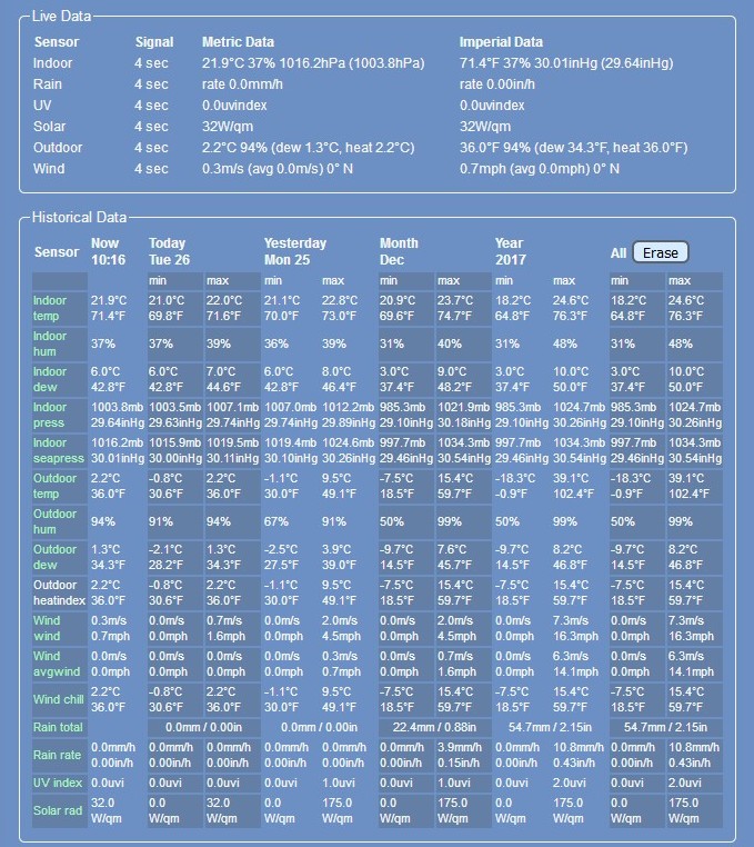

Re: Solar data problem - WH4000
Hi!
The Meteobridge reads the solar data incorrectly from WH4000 station. Currently 440 w/m2. But MB reads 175 w/m2.
Please help me!
Please help me!

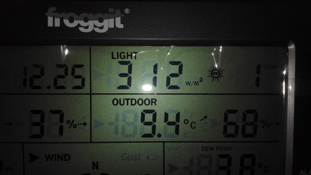

Hi!
I updated to the latest version (March 3). Now the solar data is updated, but the read data is 10 times larger.
For example:
Correct data on WH4000 display: 36.58 W/m2
Live Data on MB: 365.8 W/m2
Can you fix it?

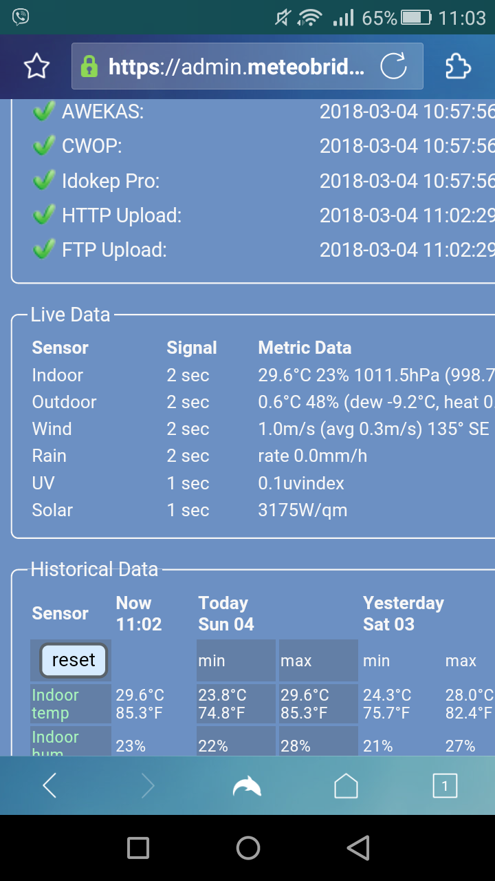

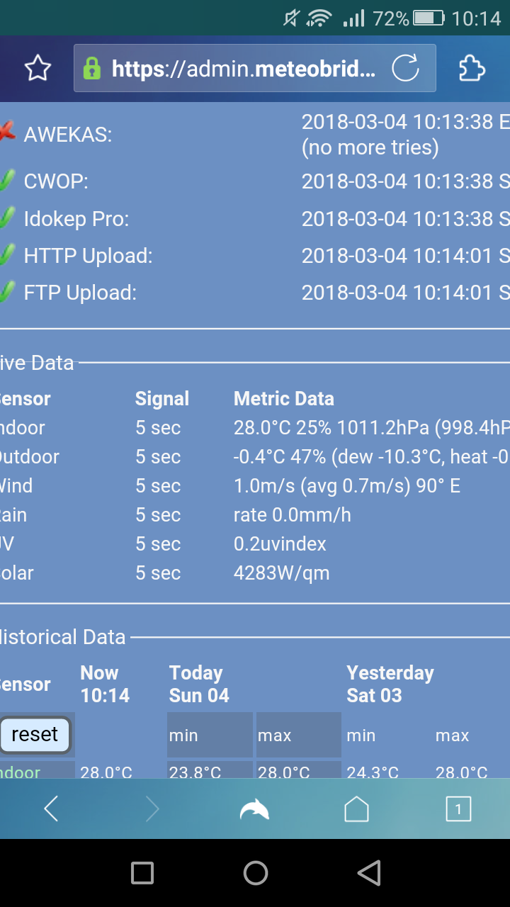

Hi!
Unfortunately, it doesn't work.
The UV value is bad (decimated).
The solar data is still bad (x10).
- Screenshot_2018-03-04-11-03-55.png (191.76 KiB) Viewed 3398 times
- Screenshot_2018-03-04-10-14-48.png (177.5 KiB) Viewed 3400 times
I fixed the UV index. But solar radiation should been fine already. Can you please try with todays update?

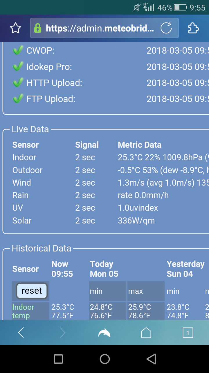

Hi!
Solar radiation is OK, updated.
I will check the UV in sunny day. Probably tomorrow.
Thank You! I will back soon.
Hi!
UV is OK.
Thank You!
UV is OK.
Thank You!
