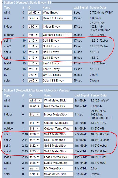

I'm using at the moment an MeteoHub where I have connected a Meteostick and Davis Envoy datalogger (both).
Meteostick is able to messure better temp. values (for extra temp sensors #soil), due the memory limit in the dataloger or console temp. values are not in steps of 0.5 but with meteostick in steps of 0.1.
I use the Davis Envoy logger to make use of the forecast message, see example below, for uploading to my website.
fcstTxt|Partly cloudy with little temperature change.
website displays then (in Dutch)
Ons weerstation Davis VP2 verwacht
Gedeeltelijk bewolkt met weinig verandering in de temperatuur
Is meteobridge Pro able to do that also or is it possible to use the internal meteostick and connect the dataloger with USB for that purpose to make use of the forecast messages?
