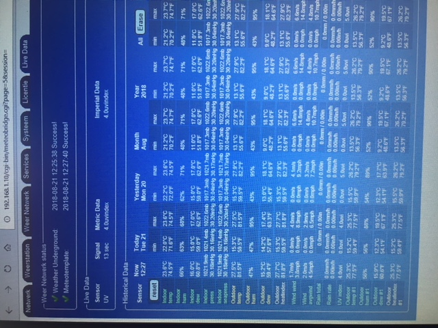

Meteobridge primaire sensor is th0temp but i want to have th1temp as my primaire sensor. But now i get the temperture of th1temp also in th0temp :oops: ? How can i solve this? HELP

Mattk wrote: Tue Aug 21, 2018 10:58 pm Go to [Live Data] tab, position mouse pointer over sensor th1temp, a box will pop up saying something like "Click to use th1temp as primary sensor"
That is what i did, but then i get de same value in th1temp en th0temp. The value from th1temp (this is the primary sensor).....

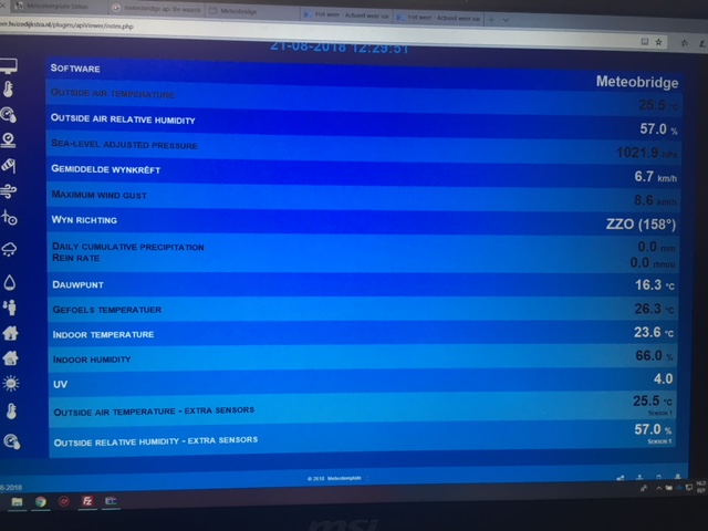

In which context do you get data from "th1temp" when asking for "th0temp"? When evaluating templates?

The template is meteotemplate.com. In the api file i get the sensor value from th1temp also in th0temp?
