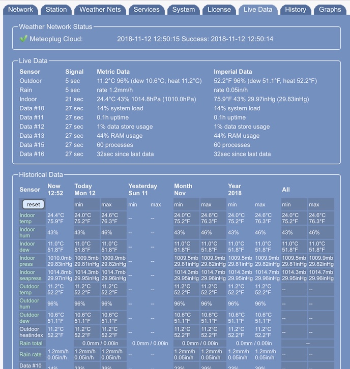

All works OK but:
1. When inserting the card and restarting there is a message that the Sd card is not supported.
Ignore that as it is caused by the old firmware.After upgrading the firmware the message is gone.
2. Indoor Temp Offset: -7C.
The console temp is not affected anymore by the offset. The live data tab shows 24 C, but the console shows 31
3. All historical data is lost.
Todays data for outside temp sensors does not show when restarted also
All historical data starts with first sensor measurement after inserting the SD card.
Will this be the case when removing the SD card. So there is no external storage for the NanoSd as with other Meteobridge devices?

Image is from after second restart and shows ore data, even yesterdays rain?

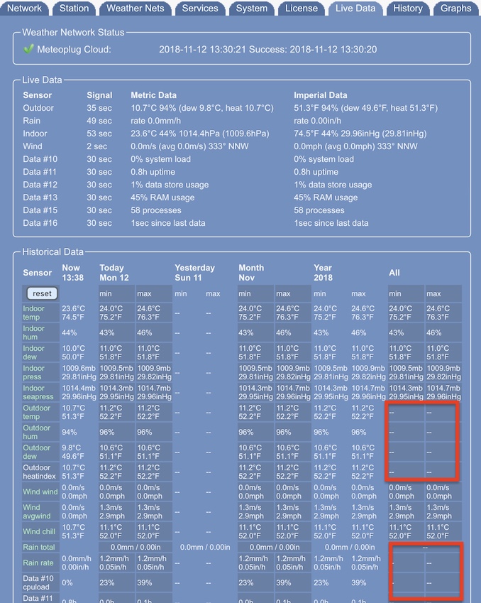

Re: Meteobridge NANO SD - a NANO with local storage
After about half an hour the errors are back again.

ok all good and done however can not add in any data to live data screen i.e records of max min etc for this year everytime i click to edit it takes me another screen(new) .. so at the moment no historical data for this year , month , yesterday and can add in totals..any ideas ?
One can not do that with a MB-Pro or NANO-SD on the live data tab. It has to be done on the History tab.weatherist34 wrote: Tue Nov 20, 2018 10:12 am ok all good and done however can not add in any data to live data screen i.e records of max min etc for this year everytime i click to edit it takes me another screen(new) .. so at the moment no historical data for this year , month , yesterday and can add in totals..any ideas ?
- Posts: 1841
ok got it just found/worked it out so i just added the dates in for max - min actually found it easier with this newer method so just a little learning curve other than that all is good thank you Wim ..
