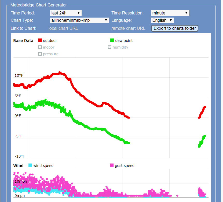

Meteobridge Pro RED no seeing temps below 0F **solved**
- ConligWX
- Posts: 329
Re: Meteobridge Pro RED no seeing temps below 0F
I take it the actual sensor is showing fine (subzero) on the console and you dont have any temperature offset at all?
I don't have a console.
Since my last message, the temp has climbed above 0F and the Meteobridge Pro Red is reporting again.

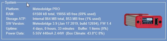

Don't worry I guess I did not see you thread. I too agree that the firmware needs more work to resolve the issue as I too have had below zero temperatures with the same results missing information. The console was able to display the temperature accurately and I do not have any offsets.
- SW_Ver.jpg (20.04 KiB) Viewed 4915 times
Thanks for digging into this. Seems like a nasty SW bug on my side.I will take care when being back from vacation end next week.
Update: As I am blocked by heavy Monsun rain to do something great at the beach I updated the software to print out the raw data stream that converts to the wrong temp data. Could you please reboot your Meteobridges to get this latest version and post the "suspicious data" messages from your log file into this forum. Having this a cure might be easy to find.

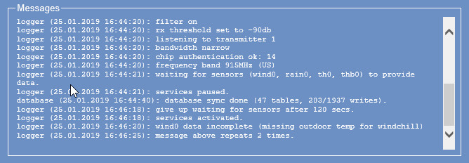

Sorry that you have poor weather when attempting a vacation that can really mess up your plans.
I have rebooted my MBPro with the new software Meteobridge 3.9 (Jan 25 2019, build 12697), FW 1.4 and only noted one item in the log but I am thinking that you need the information when the temperature is sub zero. The present forecast is predicting sub zero temperatures for mid next week so I will keep viewing the data in hopes of a returning with more information although others might have the conditions before me.
Thank you for your time looking into this it is appreciated.
- Snap1.jpg (69.53 KiB) Viewed 4865 times
Greetings, first time poster. I can also confirm that I am having problems when the temperature goes below 0F, as it currently is right now at my location. When it rose above 0F everything went back to normal and operated fine. Software version is 3.9 with a date of Jan 25, I have a VP2 that was purchased less than 2 years ago. Otherwise, everything has always worked great.
Here is what the message says:
logger (25.01.2019 19:44:31): suspicious (blocked) temp 205.7C, (81 01 c9 fb 6b 00 bf 71) -69db
logger (25.01.2019 19:44:31): Bad th0(0) sensor data, "temperature x10" (2057) out of range [-500:2000]
logger (25.01.2019 19:44:42): suspicious (blocked) temp 205.7C, (81 01 c9 fb 6b 00 bf 71) -68db
logger (25.01.2019 19:44:42): Bad th0(0) sensor data, "temperature x10" (2057) out of range [-500:2000]
logger (25.01.2019 19:44:52): suspicious (blocked) temp 205.6C, (81 01 c9 fb 5b 00 ba e4) -69db
logger (25.01.2019 19:44:52): Bad th0(0) sensor data, "temperature x10" (2056) out of range [-500:2000]
