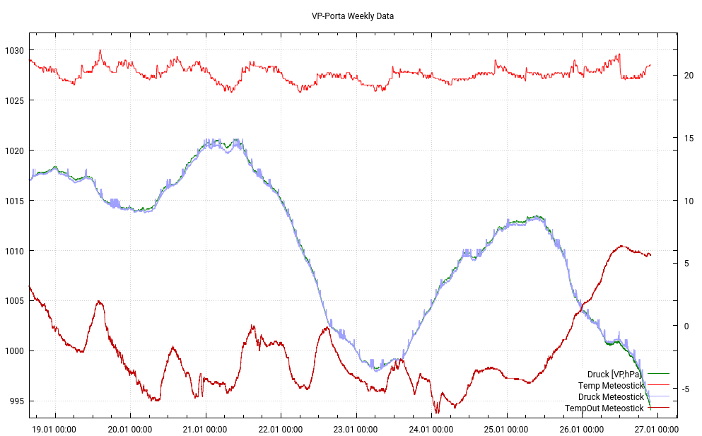

1. I've sporadic spikes in the pressure, see attached image LD001.png. The problem exists since 2007, but noticed only yet. The stick is connected with a 1m USB cable to the computer (was shipped with the stick). I've tried different positions and putting some ferrite cores on the USB-cable near the stick.
1.1 The firmware of the stick is 2.3b1. If a firmware update solves the problem, how can I do it (on a plain (opensuse) Linux system) ?
2. How can I normalize the pressure to NN. Currently I add an constant offset of 5.25 to the values (height is approx 60 meters). But this is not exactly correct, one time, the pressure is a little bit too high, at other time to low (see LD002.png).

Is the stick in a room that has pressure variations (reminds me to blower door test, etc)?

the stick is in my normal study. Unless I open the door, there should be no pressure fluctuations. I also tried different locations for the stick again (which are accessible with the 1m long connection cable), no changes. The spikes are looking for in the night when nobody is in the room.
The firmware on the stick is version 2.3b1, so older. Could an update solve the problem? But my worry is, if this goes wrong and the stick doesn't work anymore.
Enclosed a current history graphic.
