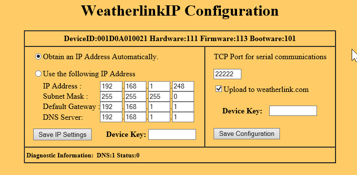

Hello all - I port forwarded 22222 between the router and weatherlinkIP but still no luck
Just to reconfirm weatherlinkIP is installed connected via Ethernet and is reporting accurately to both weatherlink live and my VWS desktop software. The only missing "link" is getting weatherlinkIP to communicate data to the weatherbridge? Any other thoughts or suggestions from the folks on this board would be most appreciated!

- WLIP config.jpg (91.76 KiB) Viewed 3320 times
Re: Trouble with Weatherbridge set up with Davis IP Logger
Interesting that your WLIP has Firmware v113 while the latest version on the Davis website is v112.
