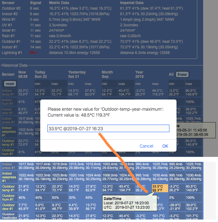

I'd like to make a request to enable Historical Data to be edited and also allow for date to be entered. This way I could rebuild the lost historical data from other database manually. Currently you can't change the date, all you can do is change the record. I like being able to mouse over and see the record date.

if you mean specific dates ? you can edit the value date time in the live data tab for day,yesterday,month,year,all time etc
33.5 @2019-07-28 16:35

Yes, thank you. For some reason when I go to edit a historical record it doesn't show me the date. It only shows to edit the data. I didn't know it was possible to enter date also. It just wasn't obvious because it wasn't presented.

gus wrote: Sun Sep 22, 2019 1:25 pm Yes, thank you. For some reason when I go to edit a historical record it doesn't show me the date. It only shows to edit the data. I didn't know it was possible to enter date also. It just wasn't obvious because it wasn't presented.
you learn something new everyday , wiki or these forums have a wealth of not so obvious ways of doing things..
https://www.meteobridge.com/wiki/index.php/Live_Data have a read its all there
A missing unit will be computed automatically. Beside values you can also change the timestamp, when the min/max event has occured. You simply do that by adding a "@yyyy-mm-dd HH:MM" string to the value. You can state the full date or just hours and minutes ("HH:MM"). Separation of numeric fields inside the datestamp you can use any non-digit character. Sequence from the end must be: minutes, hour, day, month, year. When you finally save changes, display will be refreshed and shows data you have updated.
