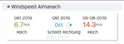

svampen wrote: Wed Oct 02, 2019 1:23 pm I can send you the translation-file, but I am still tinkering with it. Some words are not suitable etc. Hard to see all places they might go and choose the right nomenclature.
But I fixed the wind run issue as follows:
in Windspeeddirection.php, at the very end:
<div class=weather34windruntoday1>
<?php echo ' &nbsp;<windaveragevalue>',number_format($weather["windrun34"],1)."</windaveragevalue><weather34windrunspan>"?>
<?php if (($weather["wind_units"]=='km/h') || ($weather["wind_units"]=='m/s')){echo 'km';}else echo 'mi';?></weather34windrunspan></div>
<div class=windruntoday1><?php echo $lang['Wind Run']." ".$lang['Today'];?></div>
And in Livedata.php, approx line 105, I added a factor of 3,6 as such:
	//weather34 windrun based on daily average
    $windrunhr=date('G');$windrunmin=(($windrunmin=date('i')/60));$windrunformula=$windrunhr=date('G')+$windrunmin;
	$weather["windrun34"]=$weather['wind_speed_avg30']*number_format($windrunformula,1);
    //Fix for correct m/s format by RM
if ($weather["wind_units"]=="m/s") {
    $weather["windrun34"]=$weather["windrun34"]*3.6;
looking at your code no need to edit the live data simply add the formula into the file windspeeddirection.php
like this
<?php
if ($weather["wind_units"]=='m/s'){echo ' &nbsp;<windaveragevalue>',number_format($weather["windrun34"]*3.6,1)."</windaveragevalue><weather34windrunspan>";}
else echo ' &nbsp;<windaveragevalue>',number_format($weather["windrun34"],1)."</windaveragevalue><weather34windrunspan>";
;?><?php if (($weather["wind_units"]=='km/h') || ($weather["wind_units"]=='m/s')){echo 'km';}else echo 'mi';?></weather34windrunspan></div>
so I added it into windspeeddirection.php , I will upload sometime today with a few other additional tweaks . also changed the formula to a simple *400(ref Simon-conligwx) for cloud base however results are the same but ill use *400 for familiarity .
some other minor additions (wind direction icon for average) nothing significant probably won't be anything significant . next significant change will be css but thats a job for when I have some personal time for a week ..
Screenshot at Oct 03 09-48-13.png (28.75 KiB) Viewed 8471 times

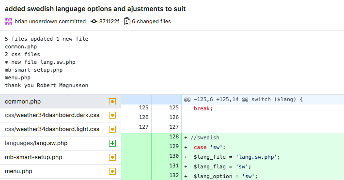

language file Swedish was added many thanks to Robert Magnusson for taking the time and checking for alignments , its important when submitting languages .
Screenshot at Oct 03 14-58-33.png (66.17 KiB) Viewed 8456 times

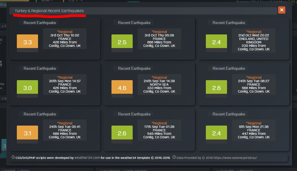

Brian.
the eqlist.php has hardcoding in it, which is not for most weather stations.
line 211
<div class="weather34darkbrowser" url="Turkey & Regional Recent Earthquakes "></div>
sorry but I dont like in Turkey:)
sorry overlooked :-(
