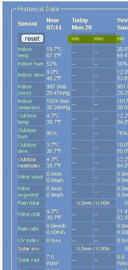

I rebooted my Meteobridge yesterday, due to general work on my network settings.
Meteobridge Nano updated to the 26 october version.
I now notice that it only seems to update the current values. There is no history. Looking in "Live data" there is only "--" in the column of todays high/low on every sensor. My webpages look very awkward with only showing the webtags where todays high/low are suppose to be.

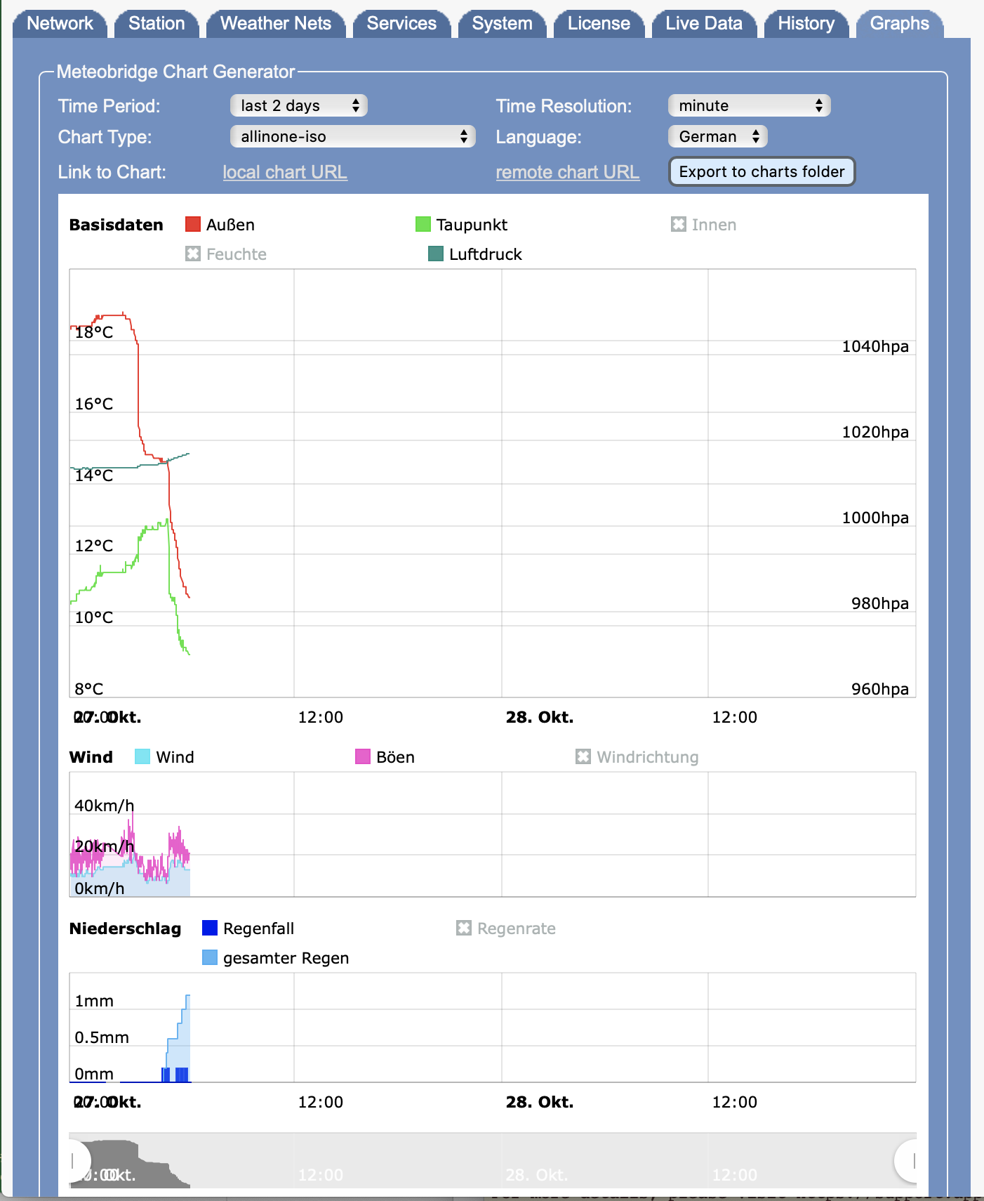

Same problem for me. It happened initially with software version 4.0
The data stopped at the time of the 06:00h reboot on Oct 27th. Due to stability issues I do a reboot every 6 hours.
I then updated to V4.2, rebooted, power-cycled. No improvement.
Thanks for your support, -pl

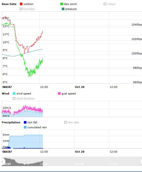

hello
exactly the same bug found today !
https://admin.meteobridge.com/cam/5c81a ... amplus.jpg
after the first observation of the absence of rain-total==0.0
see post
viewtopic.php?f=61&t=14462

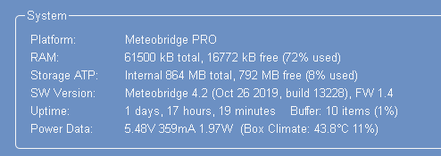

SW Version: Meteobridge 4.2 (Oct 26 2019, build 13228), FW 1.4
i have exactly the same firmware installed on another device ... NO bug !
in connection with the solar time change ?
