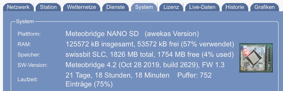

I have similar problems even a few times, today again ....
My Wlan connection lost for a minute, but after return connection, data not sent again to Home Weather Station and WU.
I noticed the failure just because the hws showed offline on displayed
The buffer on system tab kept on rising and nothing sent. I reboot the NanoSD and after that, the system works fine again.
Data not lost, after reboot comes
