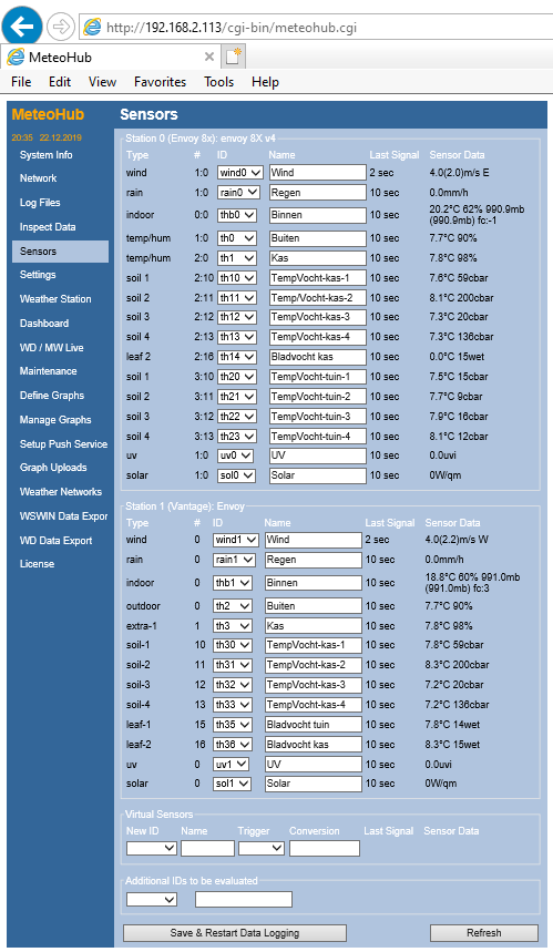

However a serious problem appeared with the two leaf wetness sensors of Soil&Leafstation nr. 1. Leaf sensor 1 wasn't showing and sensor two had erroneous readings. While the Davis console, the parallel Envoy 8 and de WDTU1.2 for the Envoy 8X showed all leaf wetness readings were normal.
When hooking up the regular Envoy 8 to the RPi, in parallel to the Envoy 8X as Station1 both leafsensors showed up and with correct data.
meteohub with Envoys-2.PNG (56.27 KiB) Viewed 11969 times
So it must something wrong in the data download from Envoy 8X.
