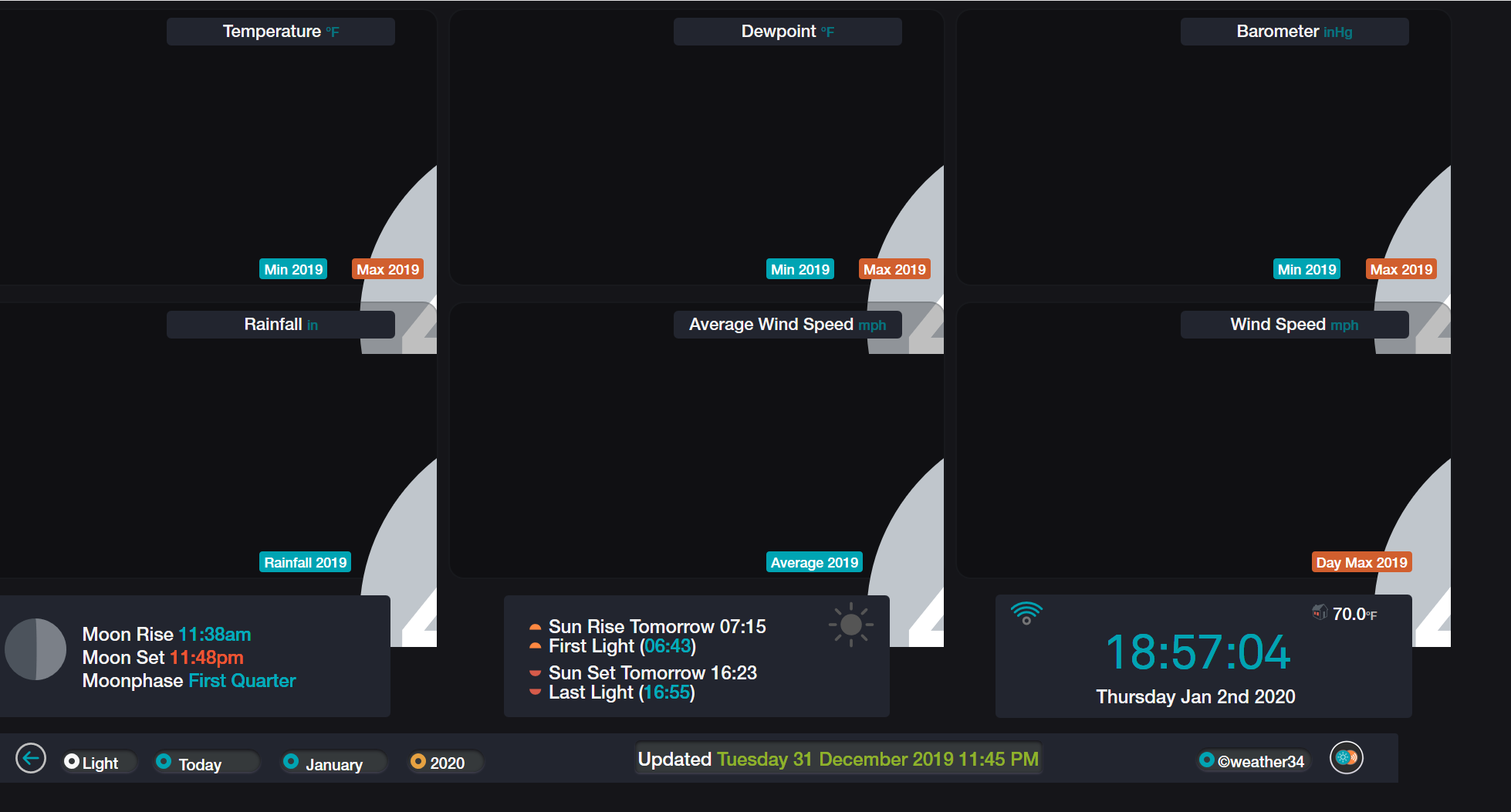

Brian, Sorry you have to deal with these last minute .. My 2019 chating is doing this and back arrow throws a 404.
..Ron

My Bad missed the additional charts when I updated ... but back arrow is still throwing a 404 from the 2019 charts.
This is the issue with the back arrow
https://weather.k1ttc.com/console/index.php should be this https://weather.k1ttc.com/console/consoledavis.php
.. Ron

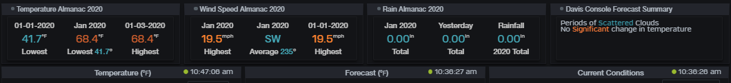

Brian, Seeing this on my site now for Rain Almanac.
73s
..Ron

hi ron
Ive loaded your MBrealtimeupload into my demo on laptop I can't reproduce this so Im at a loss .. I see that string is present in your API output instead of a value. Perhaps Ill just remove the whole last rainfall/last month feature and replace it with yesterdays total rainfall as I have no I idea why suddenly this error or string is suddenly appearing in the API instead of last months data value .More confusing it doesnt appear in all users API output .Once again this string
[rain0total-max@M1]
is not generated by the template it is generated by meteobridge api output which I have no control over.I can't fix something that I have no access to so other than remove the feature altogether is the only solution I can think of going forward.
screenshot of your data loaded in my laptop demo
03/01/2020 09:54:05 5.5 59.0 -1.9 0.9 0.4 217.0 0.0 2.3 1009.9 221.0 1 m/s C hPa mm 0.7 1009.4 9.9 9.9 4.3 22.4 35.0 5.6 4.7 5.6 20200103094305 2.7 20200103055616 1.3 20200103000001 3.6 20200103000040 1009.9 20200103094603 1008.0 20200103001704 4.2 2740 1.8 VOCORE2 -- 0.0 6.6 69.0 227.0 0.5 0.5 20200101000120 -6.4 20200102131139 -2.7 20200102234540 0.5 20200101000120 -6.4 20200102131139 0.0 68.0 20200103055728 57.0 20200103000009 -1.8 20200103091903 -3.0 20200103001450 5.4 59.0 -2.0 22.7 35 1.0 0.9 -- -- -- -- -- -- 156.0 66426 7.2 20200102150921 -2.1 20200102070530 7.2 20200102150921 -2.1 20200102070530 7.2 20200102150921 -2.1 20200102070530 6.7 20200102142139 9.4 20200101134651 9.4 20200101134651 4.3 9.9 20200101000052 9.9 20200101023212 156.0 20200103090959 473.0 20200102130357 552.0 20200101125559 552.0 20200101125559 20200103000026 1.4 20200102120739 1.4 20200101114011 1.4 20200101114011 -6.4 20200102131139 0 5.2 20200103094831 35.4 20190721145749 -15.4 20191208064914 25.9 20190720134923 -24.6 20191116144504 16.1 20191017120919 1013.3 20200102092203 1008.3 20200102234210 1013.3 20200102092203 999.8 20200101001302 1013.3 20200102092203 999.8 20200101001302 1040.9 20191212185607 974.9 20191017053506 612.6 4.2 2 53.7 09:08 12:00 -- 0.6 92.0 20200101000048 39.0 20200102132727 92.0 20200101000048 39.0 20200102132727 78.0 20200102070354 39.0 20200102132727 0.0 0.0 [rain0total-max@M1] 602.7 -- 5.5 1009.9 0.0 1.1 58.2 -1.9 0.0 59.0 2.7 1.1 20190709174443 20190709170359 20190709172913 20190709170239 20200101000052 250.0 7.2 20200102150921 -4.6 20200101211442 _Increasing clouds with little temperature change.

Ron/Brian,
I'm seeing the misalignment as well on Ron's site. I cleared cache and checked on Chrome, Firefox, Safari - Mac and Ipad. On my site it looks fine, but I have not had any rain.

Brian & Chuck,
Every PC I've run it on including iPad with Safari shows the error my NANO-SD's FW is as of Boris's latest release. Don't know either :-(
73s All
..Ron
