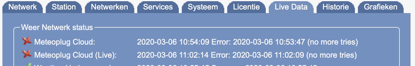

Since yesterday Meteoplug Cloud and Meteoplug Cloud (Live) give an error message (attachment). I have rebooted and reset several times, but no result. I've had this before, but then it worked again after a reboot.
Upload to partners is ok.
Schermafbeelding 2020-03-06 om 11.02.36.jpg (72.4 KiB) Viewed 1663 times

When I reset the Live Data tab this afternoon, the malfunction had disappeared. Without a reboot.
What is this?

Re: Error Meteoplug Cloud en Meteoplug Cloud (Live)
Meteoplug had a server outage.
