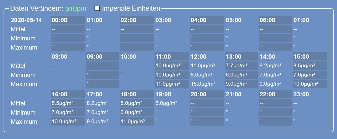

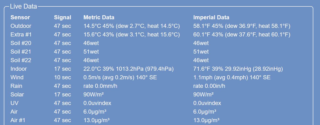

I'm trying to export all my sensor values (by minute) at once via an export script, but somehow the air quality sensor data don't come.
it (MB-pro) shows the data in the live view and in the history tab for the respective sensor (at least the min/max/avg).
It doesn't change if I choose the hourly export option.

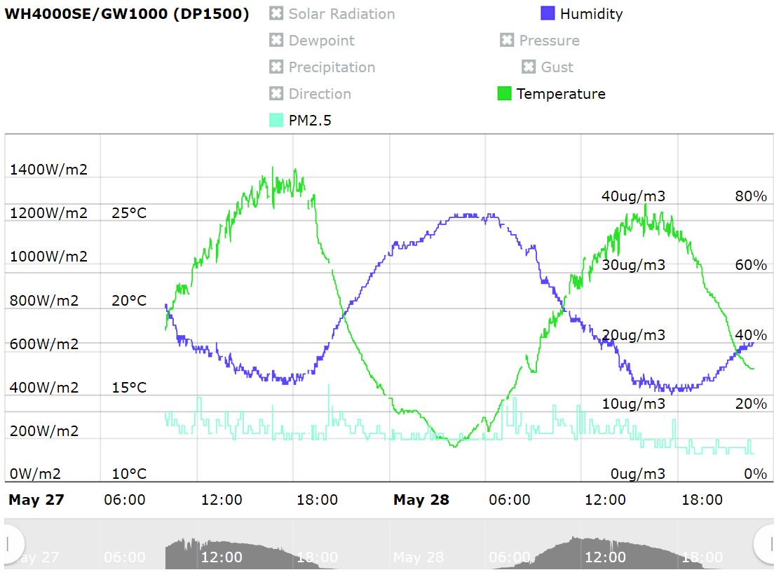

Then I tried to add the sensors to a .metachart graphics definition - it shows all sensors I define - but not the PM2.5 sensors (air0pm, air1pm).
What am I doing wrong ?
Please advise.

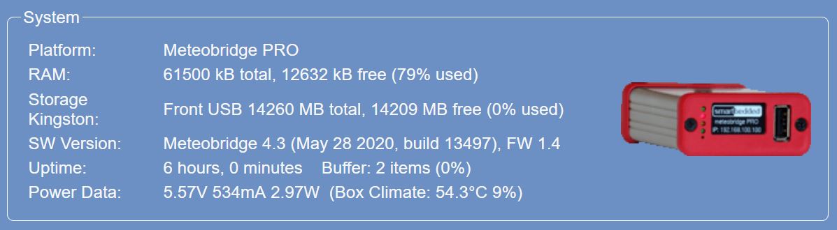

With a software update today the issue was solved and the [air0pm-avg.1:] and [air1pm-avg.1:] variables are now filled with proper values.
Meteobridge 4.3 (May 28 2020, build 13497), FW 1.4

Graph of minute based PM2.5 sensor data
