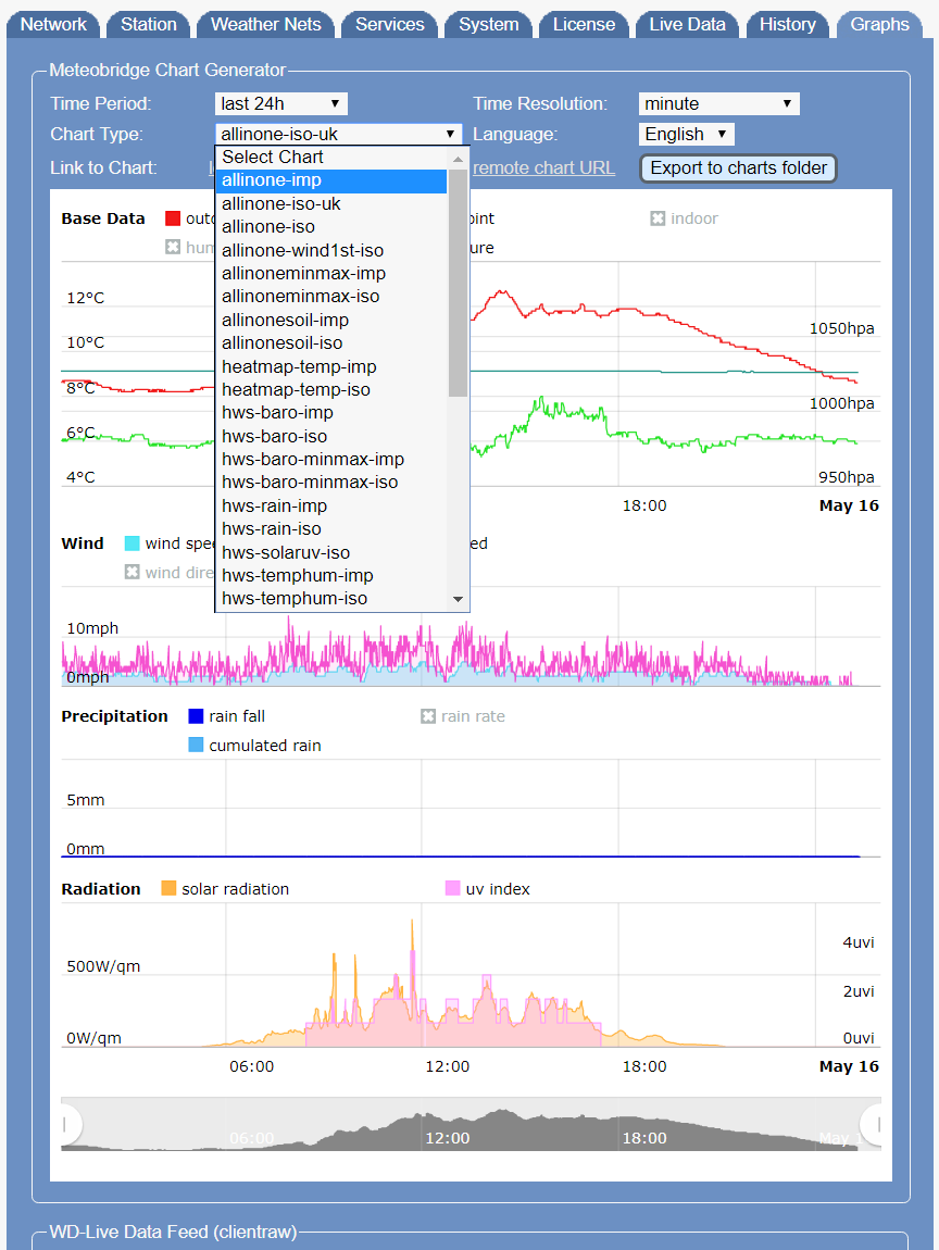

you can change the unit.
the "chart type" field is a Template in the /data/templates folder.
create a new template (from either the ISO or IMP version and adjust the new template with the correct units you want to use, give it a meaningful name and then use that template to show your graph. if you look at the image below I added a UK allinone template as the units here in the UK are both metric and imperial for some units.
check out the help here: https://www.meteobridge.com/wiki/index.php/Templates
Regards Simon
