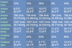

The indoor humidity from the MB Pro is showing 10% and outdoor 25% right now. Yesterday the MB PRO indoor was max 30% and the outside was max 53%. This is with the windows open all day so it should be very close I would think.
This current, today high/low and yesterday highs/lows.
