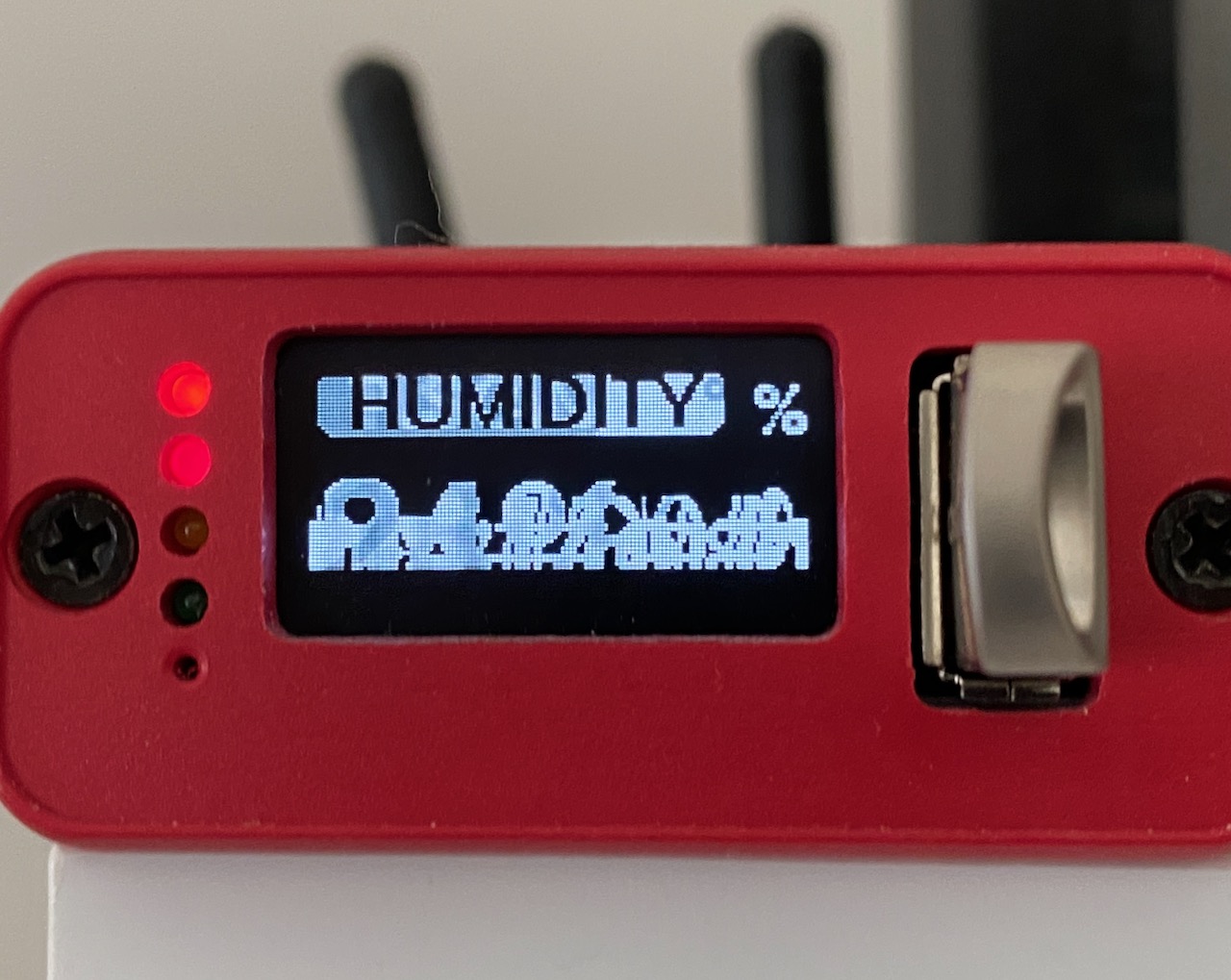

I updated today my MBPro red to the last version (from the April 7 2020 firmware version), and I observed problems with the display.
For example, using the built-in, not modified , BIG-scroll-ISO.dsp display template, the temperature, humidity and pression pages have "garbage" characters overwriting the value of the parameter (see attached image), and there is the following errors in the log :
oled (15.06.2020 07:48:11): Unknown command: #if#5.0#then##pline 105 43 20 55
oled (15.06.2020 07:48:11): Unknown command: #else##fi##disc 105 43 4
oled (15.06.2020 07:48:57): Unknown command: #if#1.1#then##pline 105 43 20 35
oled (15.06.2020 07:48:57): Unknown command: #else##fi##disc 105 43 4
oled (15.06.2020 07:49:04): Unknown command: #if#5.0#then##pline 105 43 20 55
oled (15.06.2020 07:49:04): Unknown command: #else##fi##disc 105 43 4
oled (15.06.2020 07:49:09): Unknown command: #if#5.0#then##pline 105 43 20 55
oled (15.06.2020 07:49:09): Unknown command: #else##fi##disc 105 43 4
MBPro - 1.jpeg (262.94 KiB) Viewed 2536 times

I take it you have rebooted again just in case the firmware was only updated partially or somehow corrupt? failing this, email Boris directly.

How old is the MB and how long has that screen been running?

The MB is about 2 years old, and a modified version of this screen has been running since the installation.
I observed this problem after the last update with my modified template, and to rule out a possible bad syntax in my own template, I switched to the build-in template that is showing the same problem and the errors in the log.

ConligWX wrote: Tue Jun 16, 2020 9:28 am I take it you have rebooted again just in case the firmware was only updated partially or somehow corrupt? failing this, email Boris directly.
Yes I rebooted several times. I sent therefore a email to Boris. Thanks

For your information, a new update is now available that corrects this problem.
