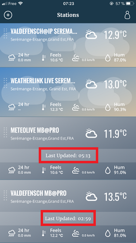

hello same malfunction encountered this morning on my two MB-Pro
stop disconnect at 02:52 and 05:27 ...also send on WL_Cloud
uoplad WL_Cloud
uoplad WL_Cloud
for log extract ! left after the same operation (clicked SAVE button) ...
kind regards
