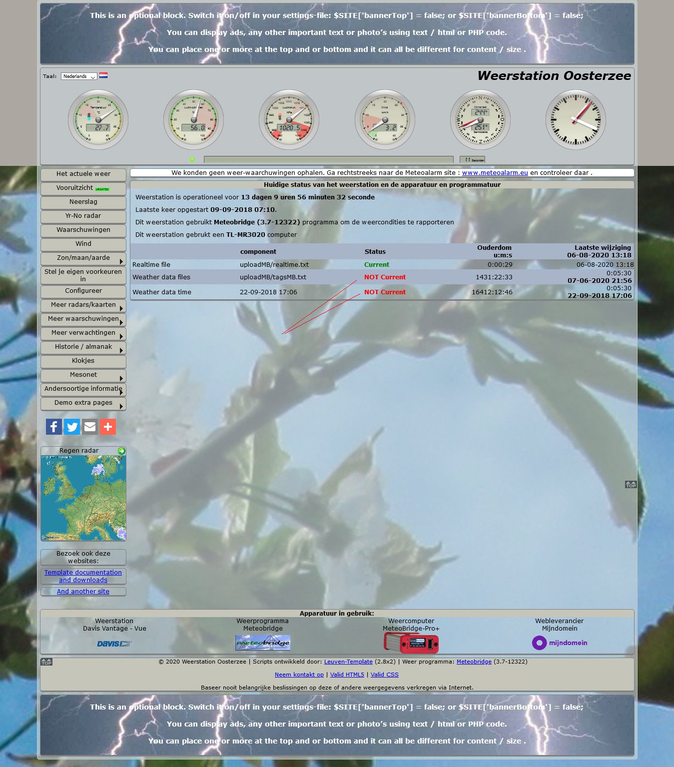

I have a MeteoBridge-Pro+ in combination with a Davis Vantage Vue. The most of it works but only the data from tagsMB.txt ?? is in-correct. Also the status info from "Weather data files" and "Weather data time" are red. See the red-lines in the attachments.

Plaat wrote: Thu Aug 06, 2020 3:41 pm I have a MeteoBridge-Pro+ in combination with a Davis Vantage Vue. The most of it works but only the data from tagsMB.txt ?? is in-correct. Also the status info from "Weather data files" and "Weather data time" are red. See the red-lines in the attachments.
The FTP-data from your weather-station/Meteobridge has never been uploaded to the expected folders.
The date time in http://www.plaatinfo.nl/weather28/uploadMB/tagsMB.txt
|date|20180922|!
|time|170646|!
is identical to the same file in the original download which seems to be uploaded at 07-06-2020 21:56
You can check the file at http://www.plaatinfo.nl/weather28/?tags&high&p=0000

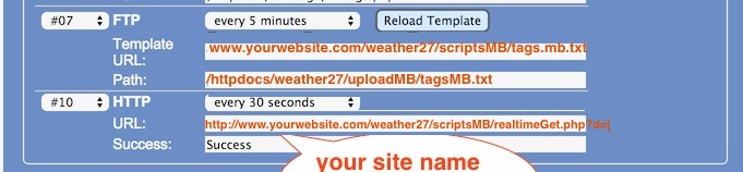

The easiest way for me to help you is adding a screenshot of your Meteobridge setting for this file,
similar to this one from the WiKi at https://leuven-template.eu/dokuwiki28/d ... l:uploadmb
You should check were the FTP-ed files arrive at your website.
For now they do not arrive in the weather28/uploadMB/ folder.
The realtime file is using HTTP for upload and is correct and contains recent data.
http://www.plaatinfo.nl/weather28/uploadMB/realtime.txt
Succes, Wim

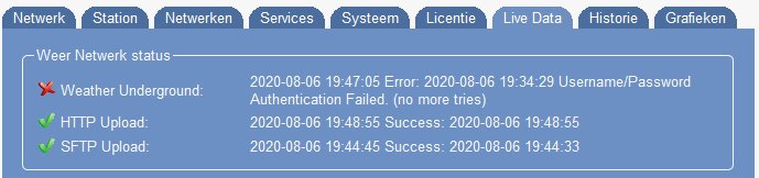

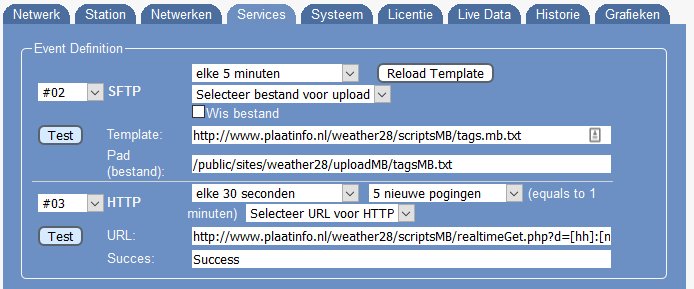

Thanks Wim, in the attachment my SFTP and HTTP info.

Re: can anyone explain the wrong data?
There seems to be a typing error in the path (pad) I think it should be:
/public/sites/www.plaatinfo.nl/weather28/uploadMB/tagsMB.txt
This document (in Dutch) from your hosting-provider explains the path to your site
https://helpdesk.mijndomein.nl/hc/nl/ca ... ing-Pakket
Uploaden naar de juiste map
Om je website te updaten en/of publiceren moet je de bestanden van je website kopieren naar de map
/public/sites/www.jouwdomeinnaam.ext/
op de web server.
There is also a test button at the bottom of your Meteobridge Services tab to test if the test-file, with a time-stamp as contents, arrived at the expected place.

Problem solved. The problem was the psw code for SFTP with my internet. A new psw and al uploads where O.K. In all psw code you see only asterix and copy of that gives the fault. Wim thanks for the info.
