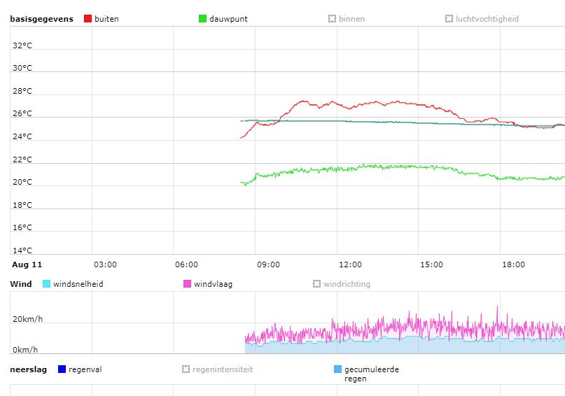

I'm now back for a few days on the island. There was again the same problem ( staion lost contact with WiFi account. I have made a screenshot of the result Image. You can see there is no data uploaded before 09:00, the moment that I repaired the connection. One more question, is it normal that the maximum period for a chart is only 2 days?

Data in per minute resolution is just stored in a RAM with a capacity of 48 or 72 hours. Per hour data is stored infinitely on SD card.
