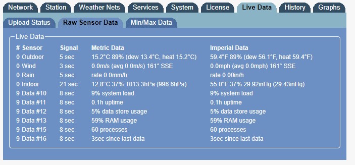

Maybe I am looking at this wrong, but when I change "Units" from Celsius to Fahrenheit on the "Weather Station" sub-tab "Settings", the "Raw Sensor Data" in "Live Data" changes to values which do not reflect the correct values.
The values for "Offset" and "Factor" are 0.000 and 1.000 respectively. I believe those are the defaults.
Note the "Outdoor" temperature with "Units" in "Weather Station" sub-tab "Settings" set to Celsius:
Set to Celsius.JPG (48.65 KiB) Viewed 4073 times
Note the change in "Outdoor" temperature with "Units" in "Weather Station" sub-tab "Settings" set to Fahrenheit:
Set to Fahrenheit.JPG (48.78 KiB) Viewed 4073 times
There is about a 17 degree temperature difference in "Raw Sensor Data" when using Fahrenheit.
Also, would it be possible to add "Raw Sensor Data" for air pressure?
Thanks!

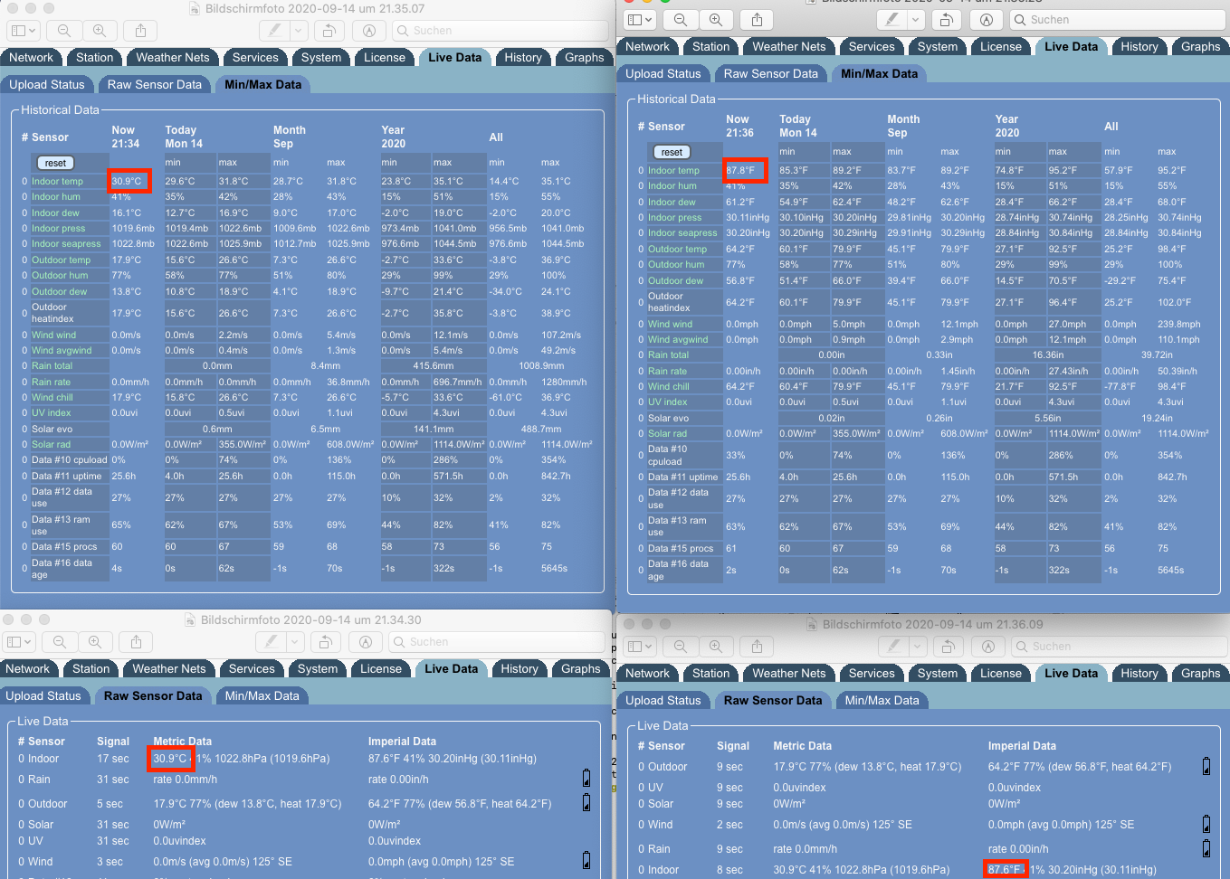

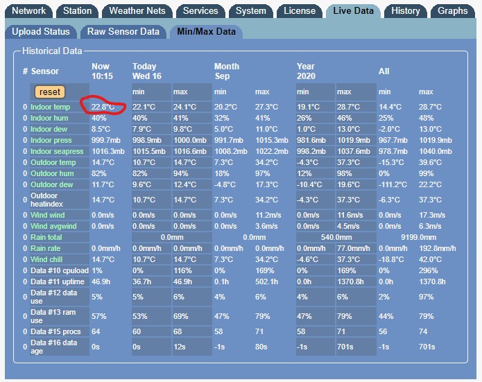

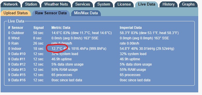

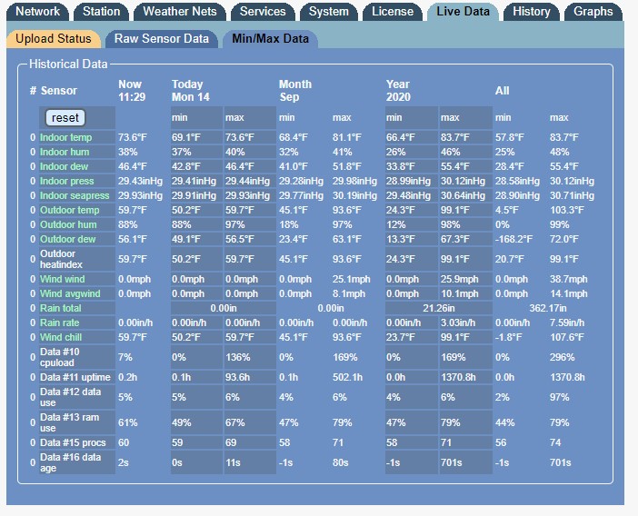

I'm seeing something similar (I think?) with the raw sensor data. it claims my interior temperature is significantly colder than it is.
But if I look at min/max pane, things look normal.
raw sensor.jpg (65.46 KiB) Viewed 3917 times
min max.jpg (122.27 KiB) Viewed 3917 times

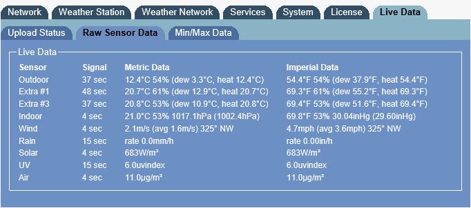

As said, I dont have that on a NANO SD, as you can see below.
Left side is without the switch to imperial, right side is with it.
So it must be something with your setup, which will need me to have a look at your Meteobridge.
