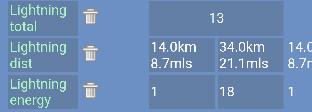

Screenshot_20200820-211357_WS View.jpg (56.27 KiB) Viewed 1479 times
[lgt0total-dmax:--] seems not to match the total shown on the GW1000. Meteobridge says 13, GW1000 says 14. A few days ago the total was off by over a hundred during a storm.
Bug? Or am I using the wrong template?
