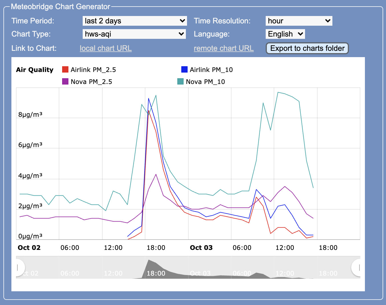

My impression was also that my Airlink is also under-reading, but it looks like it isn't that consistent. For lower levels it seems more noticable.
My Airlink PM10 data isn't that different from my Nova SDS011, but for PM2.5 there's quite some difference. And the Airlink values for PM10 and PM2.5 are much closer together than for the SDS011. Please note that the sensors aren't at the exact same position, and the SDS011 is reading the data every 2min.
Unfortunately there's no good calibrated sensor nearby, so I can't tell which one is more accurate.

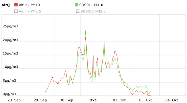

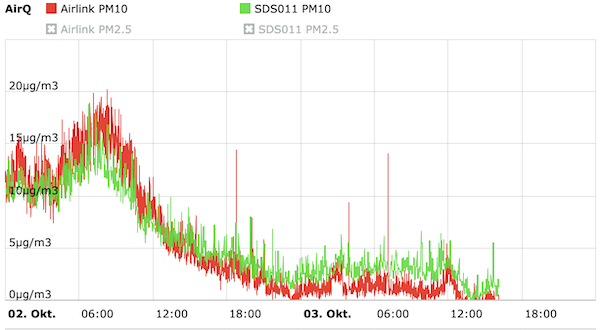

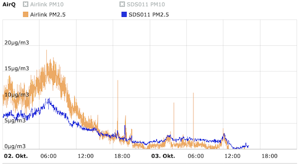

Screenshot 2020-10-03 at 3 October 2020 17.15.43 pm.png (165.94 KiB) Viewed 4614 times
They are mostly following each other but the Airlink values are consistently lower than the Nova SDS011. PM10 much worse than the PM2.5.

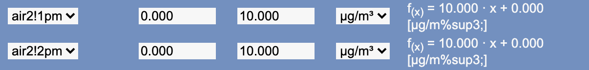

Even applying a factor of 10 against the Airlink sensors is not making much difference (if it's having any affect at all:
