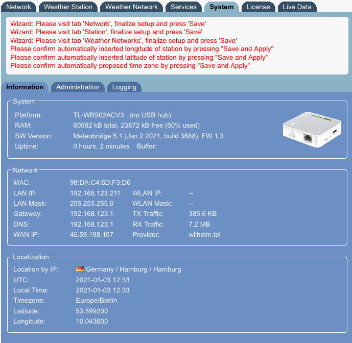

Re: Meteobridge will not load application stack. WR902ACv3
There have been no changes between 5.0 and fresh 5.1 that are expected to have an impact on the startup. I just powered-up my WR902ACv3 and it comes up fine. See yourself...
Bildschirmfoto 2021-01-03 um 13.34.10.png (131.6 KiB) Viewed 1422 times
