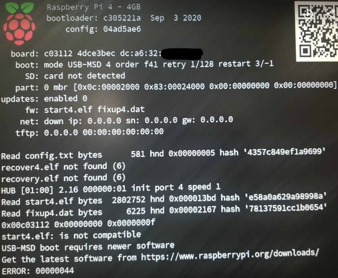

I have switched from TP-Link to a RPI 4B.
At present, it is nearly impossible to get a SLC card. I know a regular SD card can be used temporarily.
Instead of a SD card I will use a SSD drive and boot Meteobridge from the drive. I can not find anywhere that says it is possible. Has anyone tried it?
An SSD drive is comparable to an SLC card, right?
Gert
galfert
Posts: 326
Location: Orlando, FL
Re: Meteobridge supports Raspberry Pi 3B, 3B+, 4B
Post by galfert »
I tried to put the RPI image on an SSD and it didn't work...it just would not boot. :cry:
I plugged a monitor to see what was happening and it starts to load stuff and look like a normal Linux boot but then it freezes and starts back over. Error below as you can see says that the image is missing critical component to be able to boot from USB.
PI4 SSD boot MB.jpg (212.82 KiB) Viewed 63466 times
I used a Pi 4 B with latest firmware updates (the ones that unlock USB boot capability). I can USB boot Raspberry Pi OS with no SD card installed with the very same SSD (M.2 NVMe in USB enclosure). I'm also using a proper Canakit Pi 4 Power Supply 3.5A.
Meteobridge RPI | GW1000
gand
Posts: 46
Post by gand »
Hi Galfert
Thanks for your input., then it makes no sense to try.
The SSD could be a good solution, maybe in the future Boris will see if it can be done.
Gert
