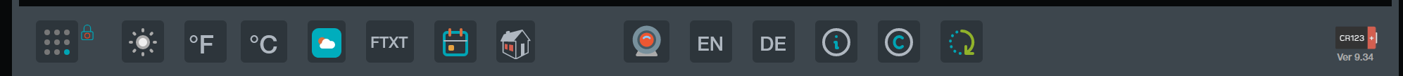

That's right, now it's all right again. The screenshot is from my iPad.
Maybe the error comes from the graphic calculation of the displayed azimuth/elevation angle?
Torsten
Re: Weather34 TEMPLATE
sorry i cant help but the azimuth, elev is the sun not moon.. if happens again please highlight it and hopefully can catch it and resolve it.. have a good day..

@Toto found it
will update it tomorrow ..
but if your brave find this line in the related moon modules just remove the decimal .1
//jday = J0 + 28 * phase + Math.floor(F);
jday = J0 + 28.1 * phase + Math.floor(F);
change to
