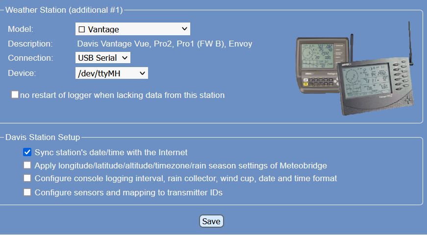

We also tried to connect the MB directly to Davis console via USB-port using the Davis 6510 USB adapter. No matter we choose in the setup tab of the MB for device (//dev/ttyMH, or //dev/ttyMH113) we can't connect via USB to the console. Is this not possible?

- Station USB Device selection.JPG (59.72 KiB) Viewed 1311 times

As it did not work first time, it could be a 'seating' problem:
Remove all power, also the batteries, from the console.
Carefully remove the logger and wait at least 30 seconds
Firmly re-insert the logger into the console.
Insert the batteries and power unit.
Deselect current selected station in the MB-Pro
Maybe do a restart and check if no new data is arriving.
Connect the USB cable into the MB-Pro
Then you should be able to select the USB-attached Davis VP2 station.

With the restart it was possible to connect the console via USB. For the Device setting we found different possibilities depending on which USB-port is used -
//dev/ttyMH -> no connection
//dev/ttyMH111-> works with USB port front
//dev/ttyMH112->works with Mini USB port rear
//dev/ttyMH113 -> ?
Is it normal, that changes in the tab PRIMARY STATION are only visible until I press the SAVE button and then the tab shows again the default values? It is the same if points are activated in the section DAVIS STATION setup.After pressing SAVE the hooks disappear.
//dev/ttyMH113 -> ?
